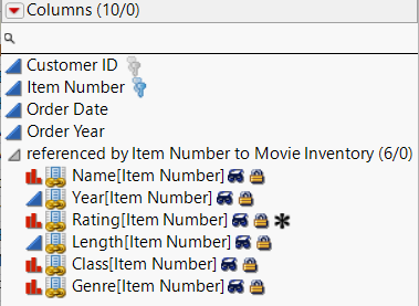

The Columns panel in a data table shows you the names of the linked columns. For example, open the Movie Inventory.jmp and Movie Rentals.jmp sample data tables to see the linked columns shown in 图 9.12.
The column name of the source column is followed by the name of the referencing column in brackets. For example, 图 9.12 shows the Name source column followed by the referencing column [Item Number] in brackets.
