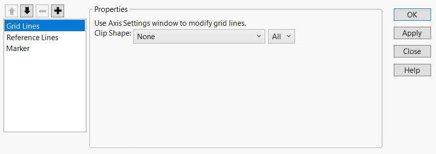

4. Right-click inside the graph and select Customize.
Figure 12.1 Customizing the Graph Options
此处显示图片
5. Click the Add button 此处显示图片 to add a new graphics script.
