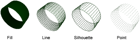

Quadric Draw Style(mode) specifies the drawing mode. The argument mode can be Fill, Line, Silhouette, or Point.
JMP uses the values that you set for Quadric Normals, Quadric Orientation, and Quadric Draw Style for subsequently generated cylinders, disks, and spheres.
Figure 13.13 Draw Styles
此处显示图片
