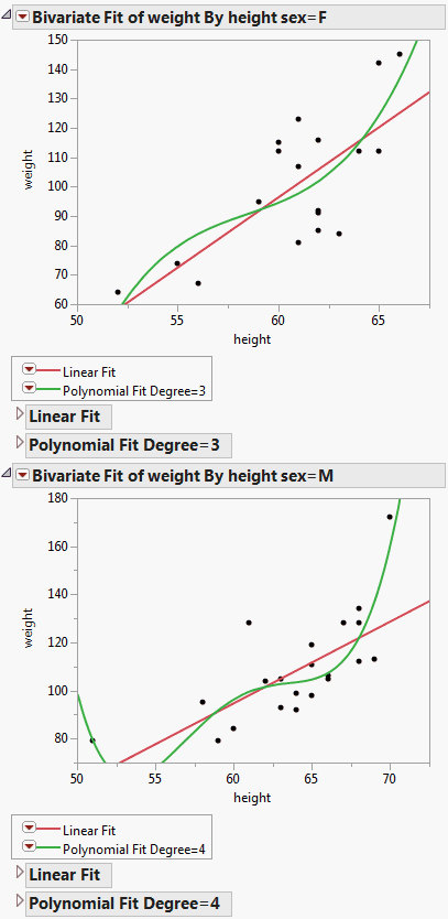

In the report window, a linear regression line is added to both graphs, with the corresponding Linear Fit reports.

In the report window, a polynomial fit line is added to the F graph, with the corresponding Polynomial Fit reports.

In the report window, a quartic fit line is added to the M graph, with the corresponding Polynomial Fit reports.
Figure 10.2 By Group Reports
此处显示图片
If you specify more than one column in By argument, graphs appear for each subgroup of each By variable. In this example, By( sex, age ) would produce graphs for females age 12, females age 13, and so on, up to age 17. It would also produce graphs for males age 12 up to age 17.
