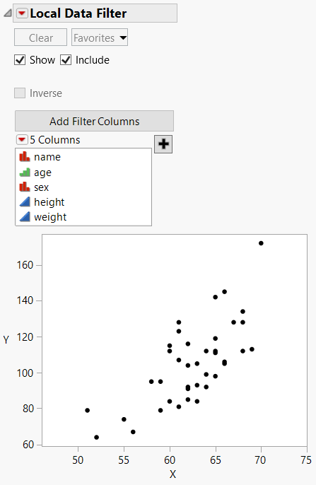

Add a Local Data Filter
A local data filter enables you to filter data in an individual report window without affecting other reports. When the local data filter is added to the platform, the reference to the data filter is returned. This provides an easy way to get access to the filter.
dt = Open( "$SAMPLE_DATA/Cities.jmp" );
biv = dt << Bivariate(
	Y( :x ),
	X( :y ),
	Automatic Recalc( 1 ),
	Fit Line( {Line Color( {213, 72, 87} )} )
dfObj = biv << Local Data Filter(
// Include Show Histograms and Bars(0) to hide them in the filter.
// Enable Include to include rows selected by the local data filter in
// calculations that are required to build graphs controlled by the local data
// filter. Deselected rows are excluded from calculations.
	Location( {566, 47} ),
	Mode( Include( 1 ) )
dfObj << Add Filter(
	Columns( :Region, :POP ),
	Where( :Region == {"C", "N"} )

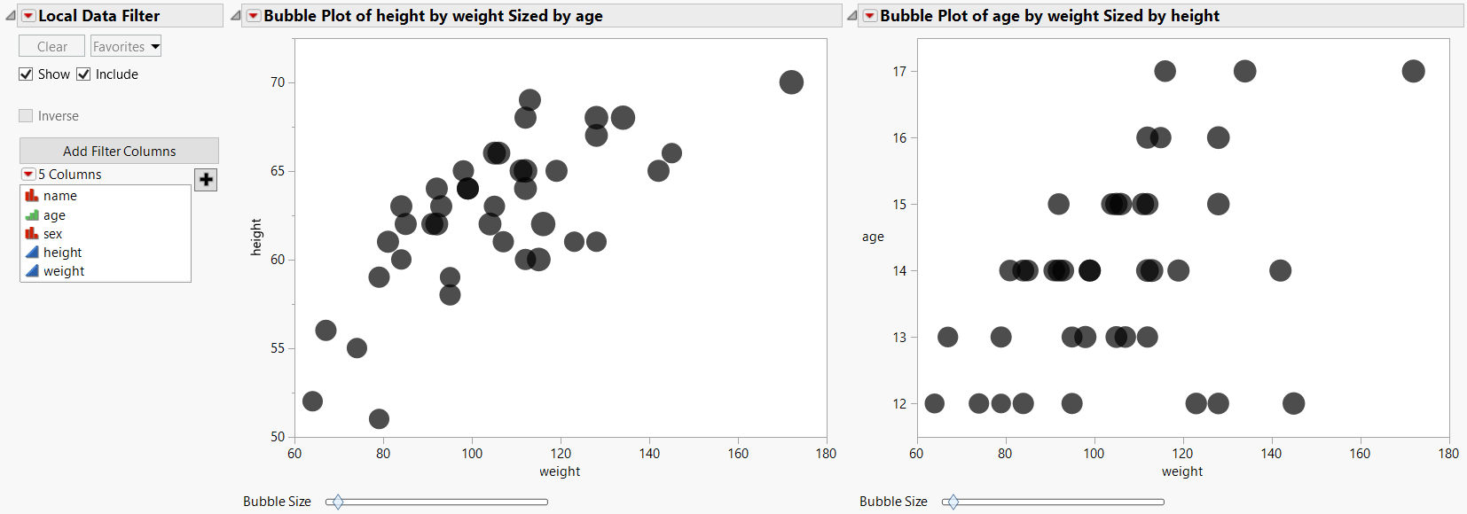

A context box can also contain several graphs with one local filter. The filtering then applies to both graphs. The following script creates two bubble plots and one data filter in one context box. See Figure 9.10 for the output.
New Window( "Shared Local Filter",
	Data Filter Context Box(
		H List Box(
			dt << Data Filter( Local ),
			Platform(
				dt,
				Bubble Plot( X( :weight ), Y( :height ), Sizes( :age ) )
			Platform(
				dt,
				Bubble Plot( X( :weight ), Y( :age ), Sizes( :height ) )
Tip: To experiment with this script, open the Local Data Filter Shared.jsl sample script.
Figure 9.10 Local Filter with Two Bubble Plots

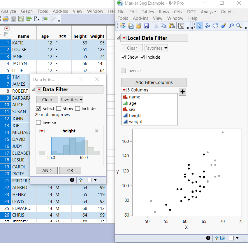

Data filters can be hierarchical. One script might generate a data filter and a local data filter. The outer data filter for the data table determines which data is available for the local data filter. To illustrate this point, the following script produces both types of data filters as shown in Figure 9.11.
Tip: The following script is part of a larger script that first builds the arrays required for a marker seg. See the Local Data Filter for Custom Graph.jsl sample script for code that builds those arrays.
New Window( "Marker Seg Example",
		V List Box(
			g = Graph Box(
				Frame Size( 300, 240 ),
				X Scale( Min( xx ) - 5, Max( xx ) + 5 ),
				Y Scale( Min( yy ) - 5, Max( yy ) + 5 ),
				Marker Seg( xx, yy, Row States( dt, rows ) )
Heights greater than or equal to 55 and less than or equal to 65 are initially filtered. Then the user can work with the local data filter to filter columns on the graph.
Figure 9.11 Data Filter Hierarchy
