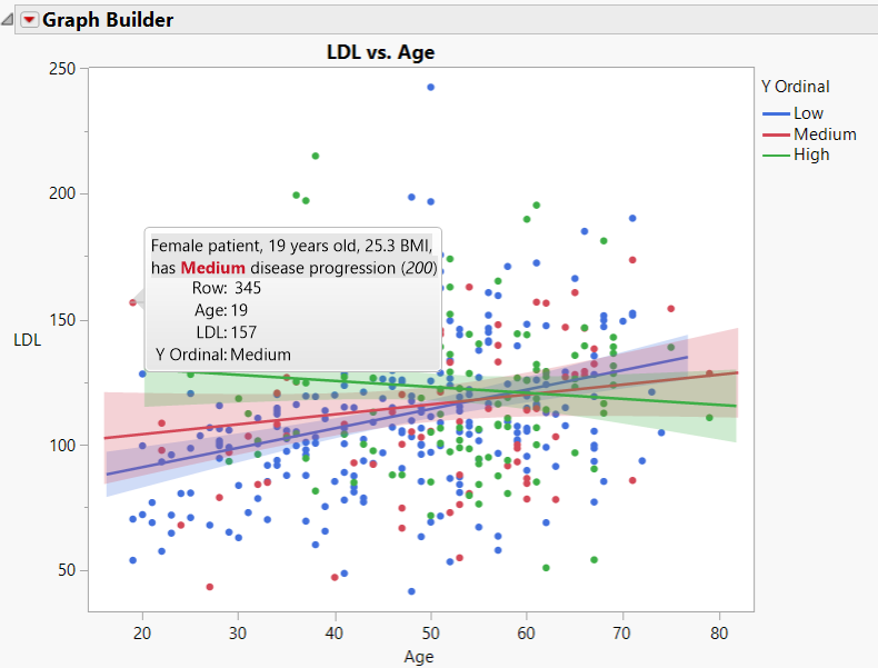

The textlet in Figure 12.39 shows text that is formatted in a gray box with red text.
Figure 12.39 Textlet Example
Textlet Example
The following script creates the textlet shown in Figure 12.39.
