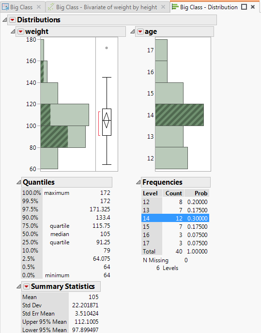

A JMP project provides a way to organize files that you use in an analysis and display the output. A simple project might display the data table, graphs, and reports on separate tabs in the project window.
project = New Project();
project << Run Script(
	dt << Run Script( "Bivariate" );
	dt << Run Script( "Distribution" );
Figure 16.1 shows the project with selected bars, showing that the graph is still linked to the data table.
Figure 16.1 Example of a Simple Project
Note: The best way to learn how to write a script for a project is to change the project extension to .zip, open the zip file, and then look for a file called project.jsl in the root directory.
