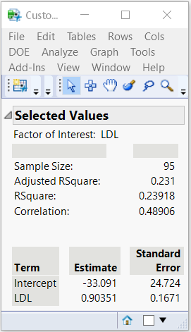

Extract Values from Reports.jsl performs a Bivariate analysis and shows results such as the sample size, RSquare, and Correlation in a new report window. Figure 19.4 shows the customized report.

Figure 19.4 Customized Report from the Bivariate Analysis
