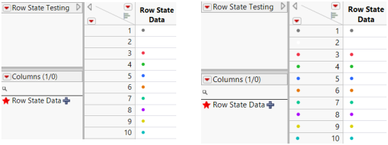

The following example creates a row state column then puts the row states into effect:
1. Submit this line to start a new data table:
dt = New Table( "Row State Testing" );
2. Submit these lines to add row states to a column and add ten rows:
dt << New Column( "Row State Data", Row State, Set Formula( Color State( Row() ) ) );
dt << Add Rows( 10 );
3. Submit this line to put the row states into effect:
For Each Row( Row State() = :Row State Data );
Figure 9.17 Table with No Row States (left) and Table with Row States (right)
This action replaces any row states in effect with the row state combination from the row state column. For more information about how to change selected attributes of a row state without changing or canceling others, see Set One Characteristic and Cancel Others.

Clear Row States
Clear Row States() removes row states from the data table. The following script assigns a row state to each row and then removes the row state.
For Each Row( Row State() = Color State( Row() ) );
Wait( 3 ); // pause for demonstration purposes
dt << Clear Row States();
To clear row states for selected rows, select the rows first and then clear the selected row states.
dt << Select Rows( [ 5 ] );
dt << Clear Selected Row States();
