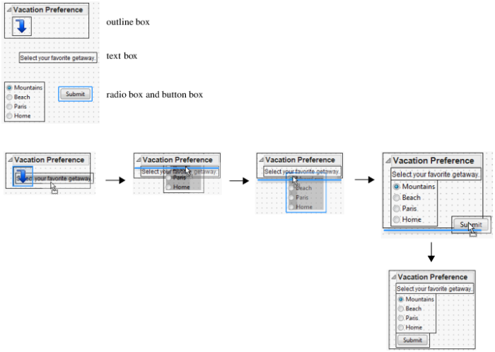

The top and left edges of an object align (or snap) to the nearest dotted grid lines as you drag them on the workspace. For a more precise placement, deselect Snap to Grid in the Application Builder red triangle menu. You can also turn off Snap to Grid for all applications in the JMP Preferences. Select File (Windows) or JMP (Macintosh)> Preferences > Platforms > JMP App to change the option.
图 16.5 shows the various methods for dragging objects inside a container.

After inserting some containers, you can change them to a different type of container without having to re-create the object. Suppose that you create a panel that contains text and a button. To see what the panel looks like as an outline, select the panel, right-click in the module, and then select Change Container > Outline Box (图 16.6).
图 16.6 Change a Panel to an Outline

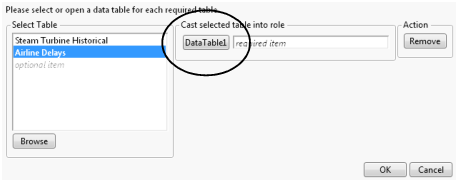

Specifies the string used when prompting the user to open a data table. 图 16.9 shows the default value.
