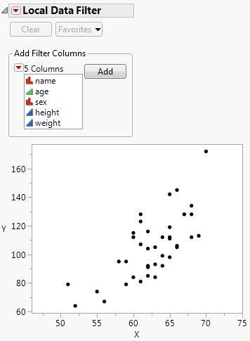

Another option is to filter data from specific platforms or display boxes. Create a local data filter inside the Data Filter Context Box() function. This defines the context as the current platform or display box rather than the data table.
The following example creates a local data filter for a Graph Box. See Local Data Filter and Graph for the output.
New Window( "Marker Seg Example",
V List Box(
dt << Data Filter( Local ),
g = Graph Box(
Frame Size( 300, 240 ),
X Scale( Min( xx ) - 5, Max( xx ) + 5 ),
Y Scale( Min( yy ) - 5, Max( yy ) + 5 ),
Marker Seg( xx, yy, Row States( dt, rows ) )
Tip: The preceding script is part of a larger script that first builds the arrays required for a marker seg. To experiment with this script, open the Local Data Filter for Custom Graph.jsl sample script.

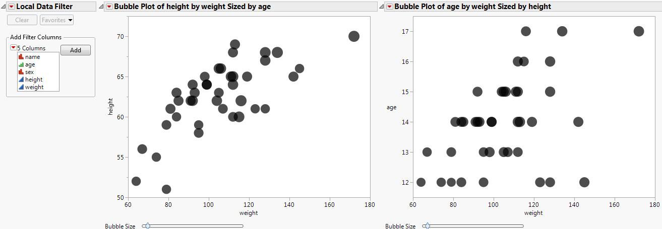

A context box can also contain several graphs with one local filter. The filtering then applies to both graphs. The following script creates two bubble plots and one data filter in one context box. See Local Filter with Two Bubble Plots for the output.
New Window( "Shared Local Filter",
Data Filter Context Box( H List Box( dt << Data Filter( Local ), Platform(dt,
Bubble Plot( X( :weight ), Y( :height ), Sizes( :age ) )),
Platform(dt,
Bubble Plot( X( :weight ), Y( :age ), Sizes( :height ) ))
Tip: To experiment with this script, open the Local Data Filter Shared.jsl sample script.

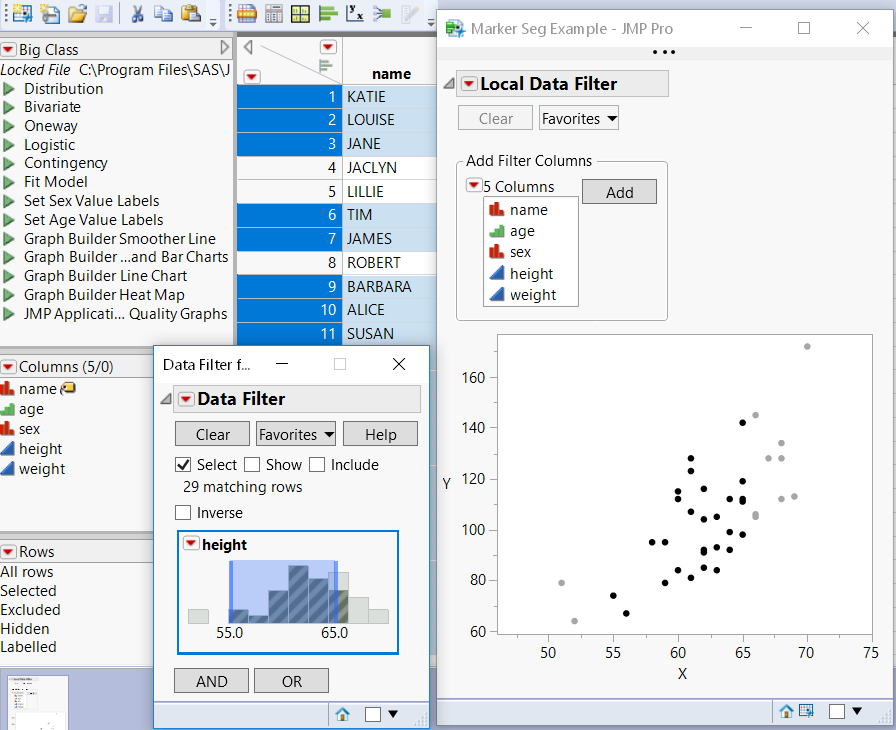

Data filters can be hierarchical. One script might generate a data filter and a local data filter. The outer data filter for the data table determines which data is available for the local data filter. To illustrate this point, the following script produces both types of data filters as shown in Data Filter Hierarchy.
Tip: The following script is part of a larger script that first builds the arrays required for a marker seg. See the Local Data Filter for Custom Graph.jsl sample script for code that builds those arrays.
V List Box(
g = Graph Box(
Heights greater than or equal to 55 and less than or equal to 65 are initially filtered. Then the user can work with the local data filter to filter columns on the graph.
