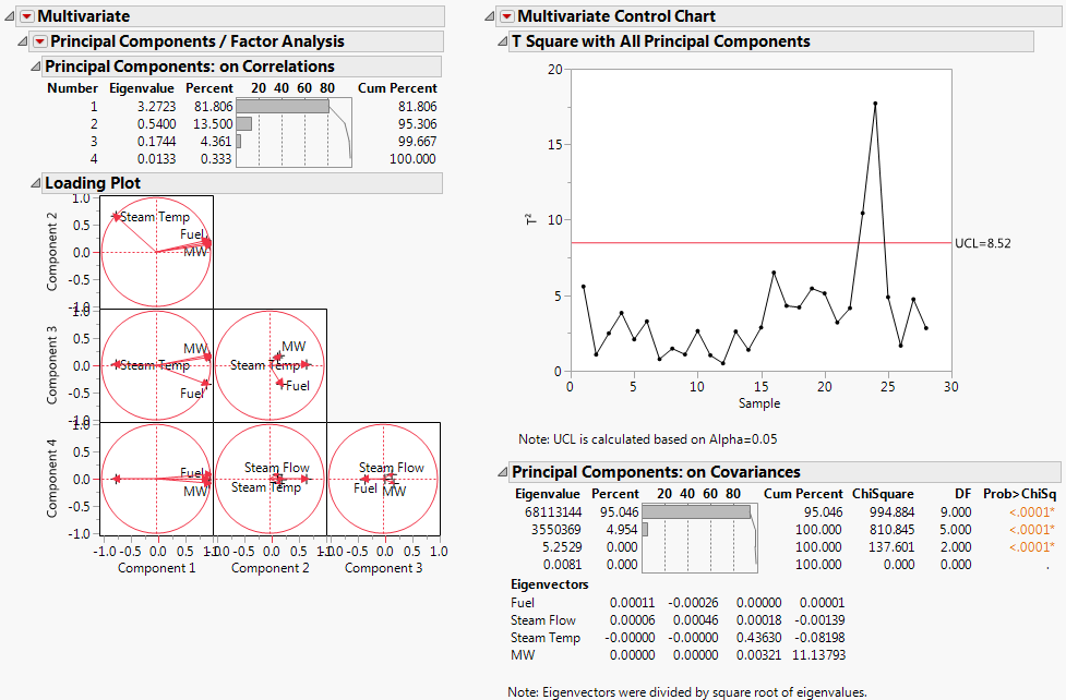

Parameterizing Variables
The following example shows how to create an application with parameterized variables. Users select the variables in a launch window, and then predefined reports are generated.
1. Select Help > Sample Data Library and open Quality Control/Steam Turbine Historical.jmp.
2. Run the Principal Component Analysis and Loading plot table scripts to generate the reports.
3. Select File > New > Application.
4. Select Blank Application.
The Application Builder window appears.
5. Enlarge the window.
6. In the Sources pane, drag each Multivariate report onto the application workspace in a single row.
7. Select Edit > Select All.
8. Select Format > Add Container > H List Box to align the reports horizontally.
9. Select each report and type yvar next to Y Variable in the Objects pane.
10. Click the Application red triangle and select Run Application.
11. Select the Fuel, Steam Flow, Steam Temp, and MW variables and then click the Y button.
12. Click OK.
New Multivariate reports appear in one window.
Multivariate Application

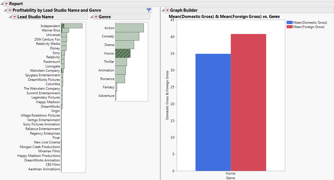

Filtering Data in Multiple Reports
In an application that contains several reports, you can select data in one report and then view only that data in all other reports contained in the same window.
To set up the filter, follow these steps:
1. Create the application and add two reports to the workspace.
2. Select both reports. From the toolbar, select the HListBox icon.
3. Right-click the primary report and select Use as Selection Filter.
This places the primary report display box in a Data Filter Source Box and the parent report display box in a Data Filter Content Box.
4. Click the Application Builder red triangle and select Run Application.
The reports appear in one window (Example of Filtered Content).
5. Test the application by selecting a histogram bar in the primary report.
Only data for the selected bar appears in the second report.

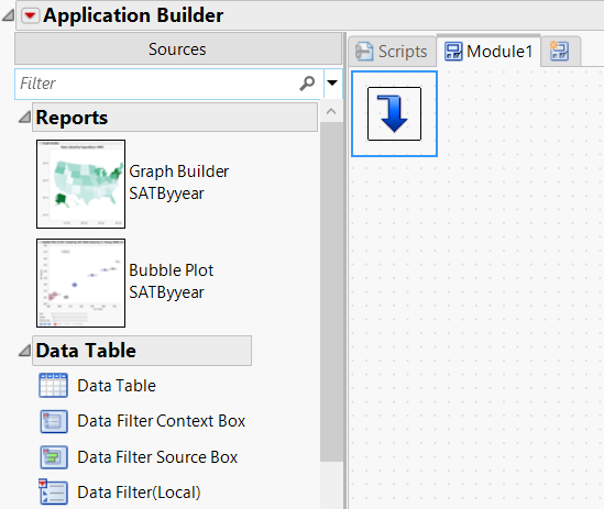

4. Select File > New > Application and choose Blank Application.
5. Double-click Data Filter Context Box.
This adds a data filter context box to the workspace. Everything placed in this box will share the same Local Data Filter.

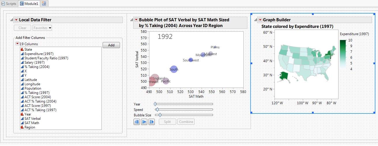

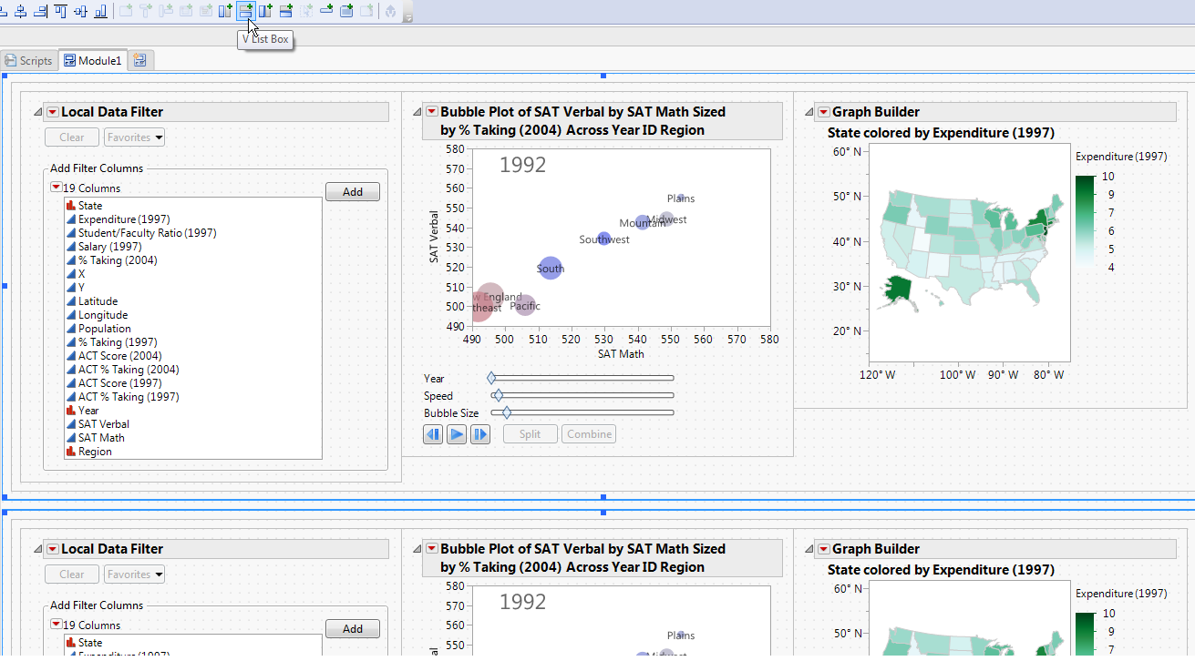

7. Now drag a Data Filter (local), the Bubble Plot, and the Graph Builder report into the H List Box.
Adding Local Data Filter and Two Reports

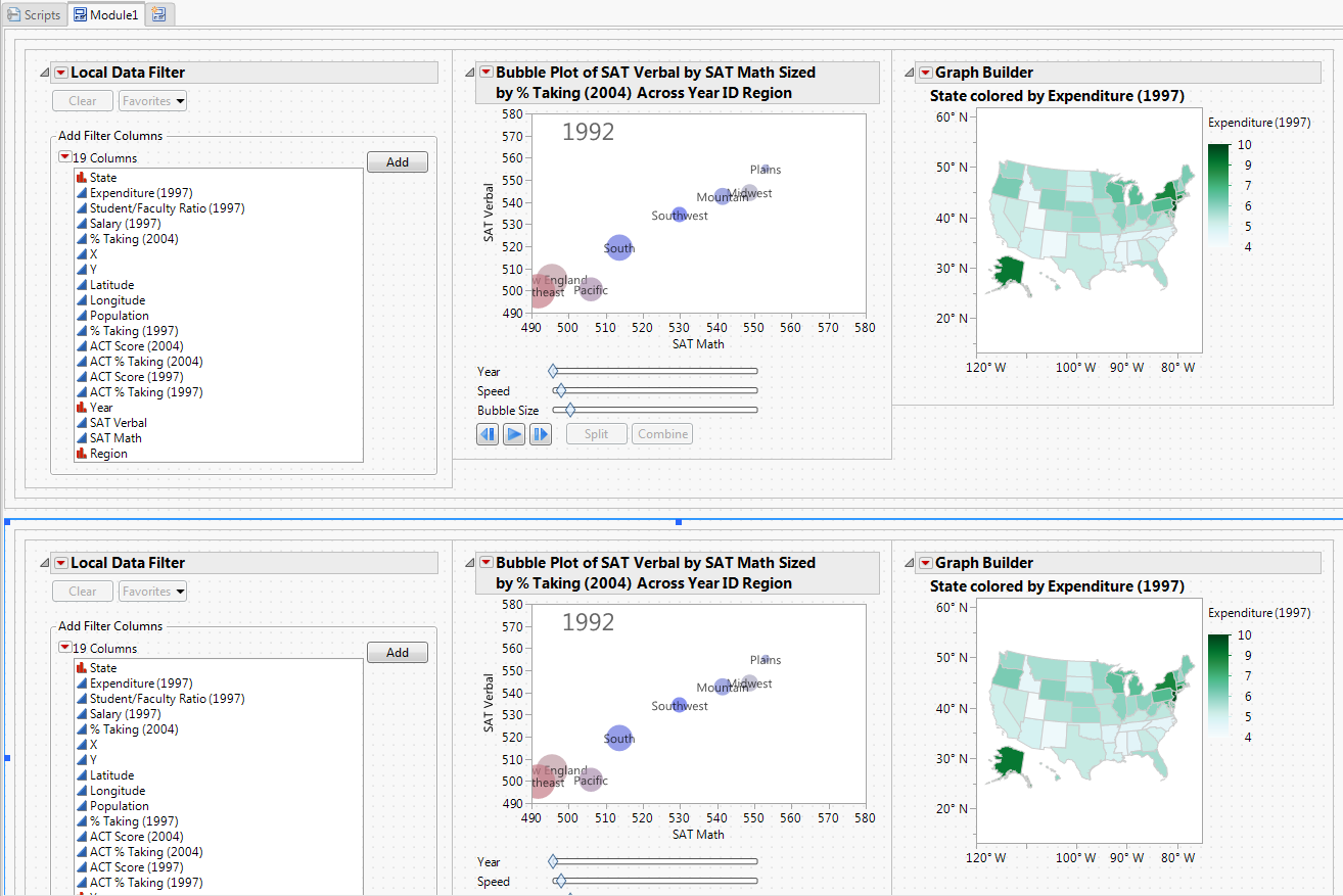

8. Select the entire Data Filter Context Box. Hold down Ctrl and drag it below itself, to place a copy below the original set of reports.
Copying Local Data Filter and Reports
9. Select both Data Filter Context boxes, then on the toolbar, click the V List Box icon.
This arranges both reports into a single list box for display purposes.
Selecting Both Data Filter Context Boxes and the V List Box Icon
10. Click the Application Builder red triangle and select Run Application.
11. In the Local Data Filter at top, click SAT Math, then click Add. Move the slider to see how it only impacts the reports at top. Do the same for the bottom set of reports.

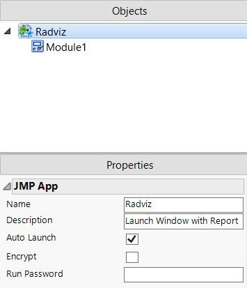

1. In the Objects pane of the blank application, select Application.
2. In the Properties pane:
– Change the Name from Application to “Radviz” and press Enter.
This name appears in the title bar when you run the application.
– Change the Description to “Launch Window with Report”.

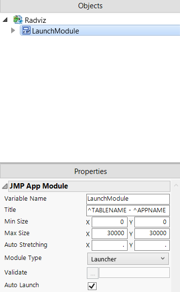

5. In the Objects pane, select Module1.
6. In the Properties pane:
– Change the Variable Name to “LaunchModule” and press Enter.
– Change the Module Type to Launcher.
– Make sure that Auto Launch is selected so that the launch window opens when you run the application.
Customizing the LaunchModule

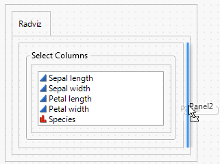

1. Drag a Panel Box (under Containers) to the right of the existing Panel Box until a blue line appears.
Adding the Panel Box
Note: Make sure that you drag the Panel Box to the H List Box shown in Adding the Panel Box.

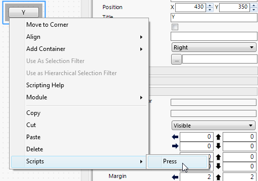

– In the Press box, type “SetY” and press Enter.
You copy and paste the script for this button later.

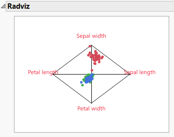

Create the Report Module
The Report Module contains an object that builds a graph.
1. In your application window, click the button to the right of the LaunchModule tab to add a new module.
2. In the Properties panel, change the Variable Name to “ReportModule” and press Enter.
3. Make sure that the Module Type is Report.
4. Deselect Auto Launch to prevent the report from opening when the application is run.
5. Drag an Outline Box (under Containers) to the workspace.
6. In the Properties panel, change the Title to “Radviz” and press Enter.
7. Drag a Graph Box (under Display) over the Outline Box arrow.
8. In the Properties panel, change the Variable Name to “Graph” and press Enter.
9. Select the outer border of the objects on the workspace.
10. Right-click and select Move to Corner.
The extra space around the selected object is removed.
11. Select File > Save to save your changes in the.jmpappsource file.

1. In your application window, click the Application Builder red triangle and select Run Application.
2. Select the Sepal length and width and Petal length and width columns, click Y, and then click OK.
A graph of the data should appear.
Iris.jmp Graph

Adding a Script Interactively
Selecting a script from the Scripts menu adds a placeholder script to the Scripts tab for the selected module. For example, the Press script shown in Adding a Script Interactively adds the following script to the Scripts tab:
Button5Press=Function({this},
	// This function is called when the button is pressed
	name = this << Get Button Name;
Fill in the placeholder script with your own JSL. In the application that you previously created, you named two variables SetY and ColumnList. Rewrite the preceding placeholder script as follows:
