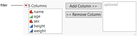

Filter Col Selector
Filter Col Selector() creates a display box that shows a list of items, for example, columns in a data table. The display box is similar to Col List Box() except that Filter Col Selector() enables the user to filter columns by name, modeling type, data type, and so on. And Filter Col Selector() supports transform columns; Col List Box() does not.
Filter Col Selector( <Data Table( name )>, <Width( pixels )>, <Nlines( n )>, <script>, <On Change( expr )>, display box args, ... );
Here’s an example that shows how to use Get Items to display a list of selected columns from the filter col selector.
win = New Window( "Filter Col Selector Example",
	H List Box(
		chooseme =
// filter col selector shows all columns, 100 pixels wide with 6 lines
		Filter Col Selector( width( 100 ), NLines( 6 ) ),
/* line up box arranges button boxes in 1 column
with 2 pixels of space around the boxes */
		Line Up Box( N Col( 1 ), Spacing( 2 ),
					Button Box( "Add Column >>",
/* append the selected column to previously
selected columns */
				listcols << Append( chooseme << Get Selected );
// get a list of selected columns from the filter col selector
					Chosen Columns = listcols << Get Items;
			Button Box( "<< Remove Column",
				listcols << Remove Selected; // remove the selected column
				Chosen Columns = listcols << Get Items; // get the selected column
// create another col list box with no columns inside
			listcols = Col List Box( width( 100 ), NLines( 6 ) ),
Filter Col Selector

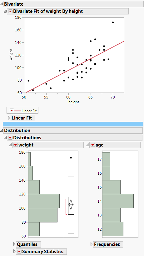

The following example puts a Bivariate and Oneway graph inside an H splitter box. Splitter boxes are especially useful when the content is set to auto-stretching as shown in the example.
win = New Window( "H Splitter Box",
	H Splitter Box(
		Size( 900, 600 ),
		biv = dt << Bivariate( Y( :weight ), X( :height ), Fit Line(), Line Style( Dotted ) ),
		one = Oneway( Y( :height ), X( :sex ), Name( "Means/Anova" )( 1 ), Mean Diamonds( 1 ) )
/* make a reference to the report layers
set the x and y axes on the frame boxes to auto stretch
when the user drags the splitter */
(biv << Report)[FrameBox( 1 )] << Set Auto Stretching( 1, 1 );
(one << Report)[FrameBox( 1 )] << Set Auto Stretching( 1, 1 );

Here is an example of creating a sheet with four plots: a Bivariate plot, a Distribution, a Treemap, and a Bubble Plot.

Another way to get journal text is to send the Get Journal message to a display box. For example, run the following script and copy the journal text from the log into the Journal Box() function:
biv = dt << Bivariate( y( :weight ), x( :height ) );
rbiv = biv << Report;
Print( rbiv << Get Journal ); // print the journal to the log

win = New Window( "Spacer Box",
	V List Box(
		Outline Box( "Bivariate",
			biv = dt << Run Script( "Bivariate" ),
			// Color string consists of percentages of RGB values
			Spacer Box( Size( 450, 15 ), Color( {.53, .80, .98} ), )
		Outline Box( "Distribution",
			V List Box( dist = dt << Run Script( "Distribution" ), )
Spacer Box Example

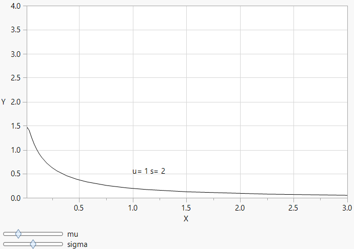

// Slider LogNormal
lU = 1;
lS = 2;
win = New Window( "LogNormal Density",
	V List Box(
		gr = Graph Box( // define the arguments and script for the graph box
			Frame Size( 500, 300 ),
			X Scale( 0.01, 3 ),
			Y Scale( 0, 4 ),
			XAxis( Show Major Grid ),
			YAxis( Show Major Grid ),
			Y Function(
				Exp( -(Log( x ) - Log( lU )) ^ 2 / (2 * lS ^ 2) ) / (lS * x *
				Sqrt( 2 * Pi() )),
				x
/* display the specified text at 1 on the x axis
and .5 on the y axis */
			Text( {1, .5}, "u= ", lU, " s= ", lS );
/* define the minimum and maximum range
insert the value of lU and updates the display as the slider moves */
		H List Box( Slider Box( 0, 4, lU, gr << Reshow ), Text Box( "mu" ) ),
			H List Box(
			Slider Box( 0, 4, lS, gr << Reshow ),
			Text Box( "sigma" )
		Button Box( "Reshow", gr << Reshow )
Show( gr );
gr << Reshow; // update the display of the Graph Box
Example of Sliders and Buttons in a Report Window

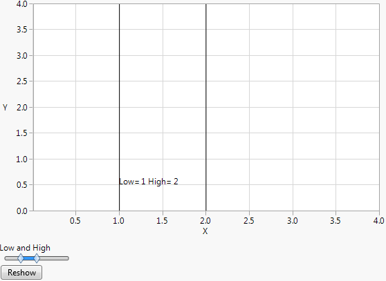

The following script uses a Range Slider Box() instead of a Slider Box() to perform the same function:
lLow = 1;
lHigh = 2;
win = New Window( "Range Slider",
	V List Box(
		gr = Graph Box(
			X Scale( 0.01, 4 ),
			Y Scale( 0, 4 ),
			XAxis( "Show Major Grid" ),
			YAxis( "Show Major Grid" ),
			X Function( lLow, x );
			X Function( lHigh, x );
			Text( {1, .5}, "Low= ", lLow, " High= ", lHigh );
		V List Box(
			Text Box( "Low and High" ),
			sb = Range Slider Box( 0, 4, lLow, lHigh, gr << Reshow )
		lLow = 1;
		lHigh = 2;
		gr << Reshow;
		sb << Reshow;
Show( gr );
gr << Reshow;
Example of Using Range Slider Box

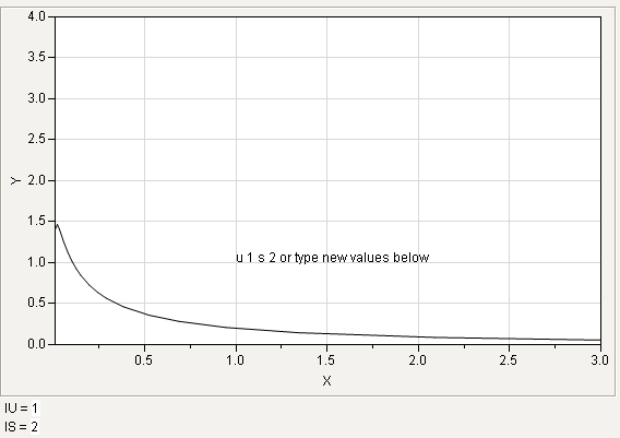

The script below is similar but uses Global Box() as an editable text box instead of two Slider Box() controls:
// Global LogNormal
lU = 1;
lS = 2;
	V List Box(
		gr = Graph Box( // define the arguments and script for the Graph Box
			X Scale( 0.01, 3 ),
			Y Scale( 0, 4 ),
			Y Function(
				Sqrt( 2 * Pi() )),
				x
// display the specified text at 1 on the x and y axes
			Text( {1, 1}, "u= ", lU, " s= ", lS, " or type new values below" );
// display the lU variable value in the first H List Box
		H List Box( Global Box( lU ) ),
// display the lS variable value in the second H List Box
		H List Box( Global Box( lS ) )
Example of Using a Global Box Instead of Sliders

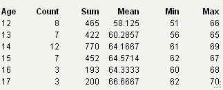

Example of Constructing a Summary Results Report
The following example uses the Summarize() function to collect summary statistics on the Height column of Big Class.jmp and then uses display box constructors to show the results in a nicely formatted window.
Summarize(
	a = by( age ),
	c = count,
	sumHt = Sum( Height ),
	meanHt = Mean( Height ),
	minHt = Min( Height ),
	maxHt = Max( Height )
win = New Window( "Summary Results",
	Table Box(
		String Col Box( "Age", a ),
		Number Col Box( "Count", c ),
		Number Col Box( "Sum", sumHt ),
		Number Col Box( "Mean", meanHt ),
		Number Col Box( "Min", minHt ),
		Number Col Box( "Max", maxHt )
This produces the summary results shown in Producing a Customized Summary Report.
