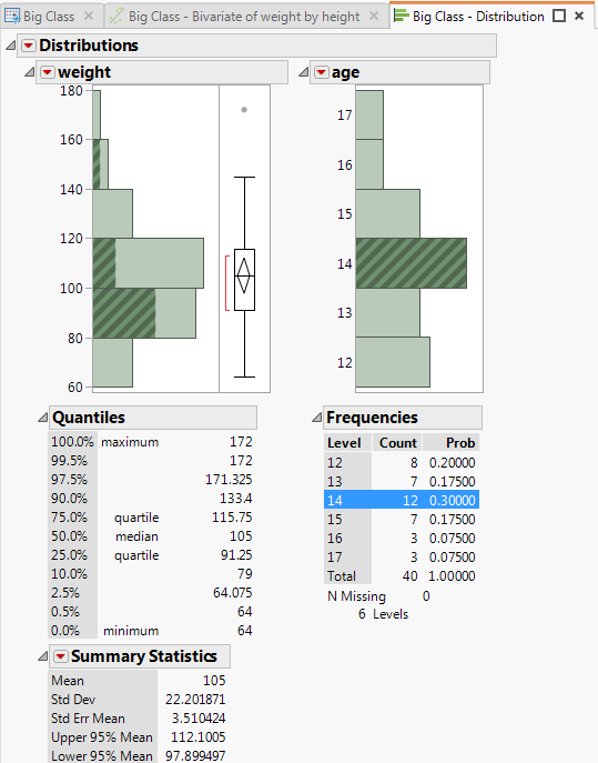

A JMP project provides a way to organize files that you use in an analysis and display the output. A simple project might display the data table, graphs, and reports on separate tabs in the project window.

Example of a Simple Project shows the project with selected bars, showing that the graph is still linked to the data table.
