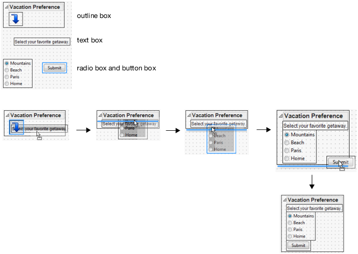

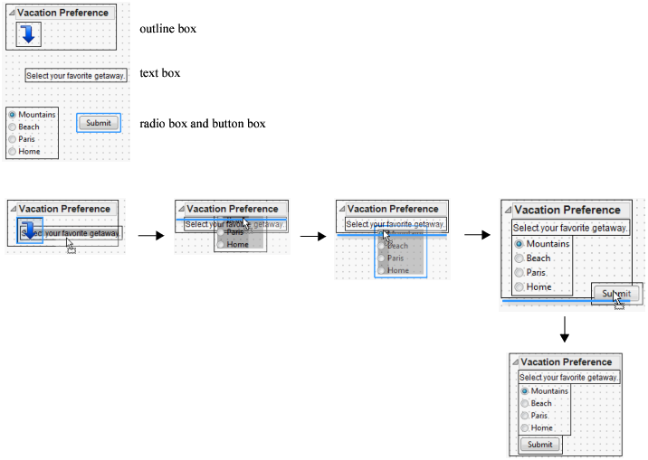

Drag an Object
One way to position objects is by dragging them around the workspace.
• The top and left edges of an object align (or snap) to the nearest dotted grid lines as you drag them on the workspace. For a more precise placement, click the Application Builder red triangle and deselect Snap to Grid. You can also turn off Snap to Grid for all applications in the JMP Preferences. Select File (Windows) or JMP (macOS)> Preferences > Platforms > JMP App to change the option.
• Position objects in containers instead of positioning them independently on the workspace. For example, place two button boxes in a V List Box to align them vertically.
• When you drag an object, press SHIFT to restrict movement to a single axis (for example, to move the object horizontally without moving the vertical position).
• When you drag an object into a container, the arrow indicates where you can drop the object.
• When you drag an object over another one, a blue line shows where you can drop the object.
Examples of Dragging Objects into a Container shows the various methods for dragging objects inside a container.

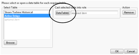

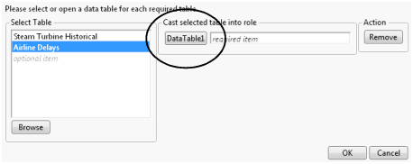

Label
Specifies the string used when prompting the user to open a data table. Label in Data Table Prompt Window shows the default value.
Location
Determines how the data table used in the application is selected when the user runs the application.
– Current Data Table: Uses the current data table. If no data tables are open, the user is prompted to open one. This option gives users the flexibility to use their own data.
– Full Path: Uses the data table specified in the Path property.
– Name: Uses the first open data table with the specified name. Otherwise, JMP uses the data table specified in the Path property. Note that if the application is moved to another computer, the link to the data table is broken. Consider storing the data table in a shared location.
– Prompt: Asks the user to select an open data table or browse to select a data table.
– Script: Uses the data table defined in the application or module script.

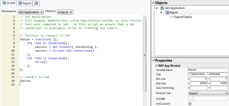

Write Scripts
After adding an object to the module, you write a script for the object to provide functionality. For example, you might want the user to click a button, select a directory, and then select a data table. Or you might have an application that displays a different graph based on which radio button the user selects.
Application and Module Namespaces
To prevent variable names and values from conflicting among scripts, Application Builder automatically creates the Application namespace and a namespace for each module as follows:
• In the Application namespace, you write scripts that are executed when the user runs the application. Functions defined in the Application namespace can be used in any module.
• In the Module namespaces, you write scripts that are run when an instance of that module is created. If clicking a button in the application opens a new launch window, that launch window is an instance of the module. Two instances of the same module have their own copies of any variables or functions.
To see the scripts in these namespaces, click the Scripts tab and then select the namespace in the Namespace list (or in the Objects pane).
