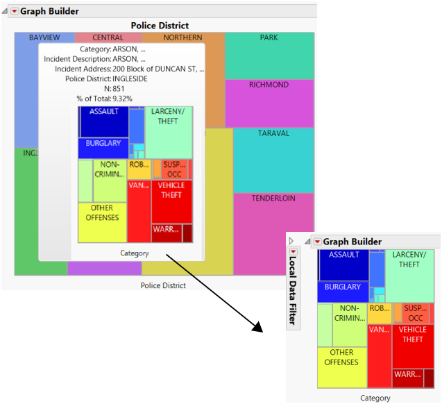

A drill-down graph is created when you click on the thumbnail. Clicking on the hover graph opens it in a new window, enabling you to see the graph in more detail and also make modifications such as changing the data filter. For example, you can press Ctrl and click a cell on a treemap to see details about the data (Example of a Drill-Down Graph on a Hover Label). Press Alt to replace the contents of the last launched window instead of opening a new one.
• The Next in Hierarchy column property enables you to define the behavior of categorical drill downs in preset graphs. This column property defines only one level of the drill down, from a category in a grouping role in the current visualization to the category in the grouping role in the next one, launched by the graphlet.
• If the Next in Hierarchy column property is not defined, the list of categorical or nominal columns from the data table that have not been added to a filter is used.
Notes:
• The Next in Hierarchy column property is not supported in graphlets defined using Paste Graphlet. See Customize Graphs in Using JMP for details about the Paste Graphlet command.
• If there is no measurement, JMP tries to get one from the data table and uses Count (or no measurement) if there are no numeric columns in the data table.
Example of a Drill-Down Graph on a Hover Label shows drilling-down on a cell in a treemap.
The following script creates the simplified versions of the treemap presets shown in Example of a Drill-Down Graph on a Hover Label.

/* Graph Builder treemap based on the first level of our hierarchy, "Police District" */
gb = dt << Graph Builder(
	Size( 495, 440 ),
	Show Control Panel( 0 ),
	Variables( X( :Police District ) ),
	Elements( Treemap( X ) )

frame << Set Graphlet(
	// define the thumbnail and launch treemap
	Picture(
		// next-level grouping is retrieved from the Next in Hierarchy property
		local:propColName = local:_groupings[1] << GetProperty( "Next In Hierarchy" );
		local:nextGrouping = Column( local:_dataTable, local:propColName );
		// define the Graph Builder graph for the thumbnail
		Graph Builder(
			Size( 200, 250 ),
			Show Legend( 0 ),
			Show Title( 0 ),
			Show Footer( 0 ),
			Variables( X( local:nextGrouping ) ),
