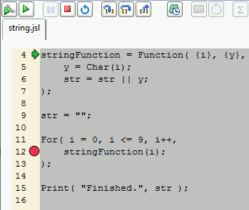

1. Open the string.jsl sample script and click the Debug Script button.
2. Click in the margin for line 12 to add a breakpoint.
You should have a breakpoint for the following expression inside the For() loop:
stringFunction(i);
Set the Breakpoint
3. Click Run.
The first two expressions are evaluated:
– stringFunction is defined as a function.
– str is defined as an empty string.
Both variables and their types and values have been added to the Globals list. In addition, the For() loop has been evaluated up to the line with the breakpoint, shown in Set the Breakpoint.
– i has been assigned to 0.
– i and its value and type have been added to the Globals list.
– i has been determined to be less than or equal to 9.
– stringFunction() has not yet been called.

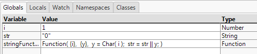

4. Click Run again.
The script runs until it hits the breakpoint. The results are shown in Global Variables at First Breakpoint.
– stringFunction() is called, evaluated, and returns to the loop.
– i is incremented and determined to be less than or equal to 9.
– In the Globals list, i is now 1 and str is now “0”.

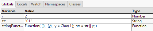

5. Click Run again.
The script runs until it hits a breakpoint. The results are shown in Global Variables at Second Breakpoint.
In the Globals list, i is now 2, and str is now “01”.
You can continue to click Run and watch i and str change with each iteration of the loop. Or, click Run without breakpoints to complete running the script and exit the Debugger.

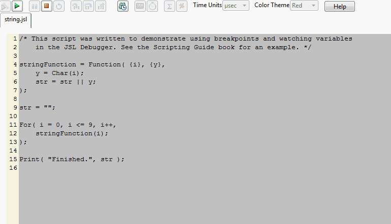

1. Open the string.jsl sample script.
2. Click the Debug Script button .
3. Click the Profile JSL Script button .
Initial JSL Profiler Window

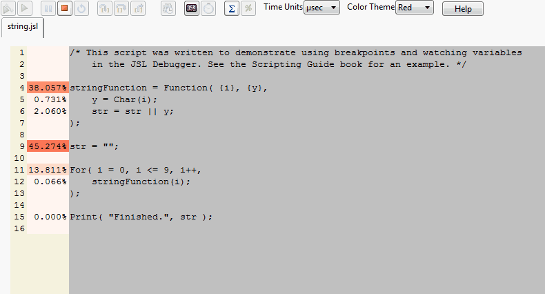

4. Click the Run button to start profiling.
The profiler collects information on the number of times a statement is executed and the time it takes to execute it. Time is cumulative and collected each time a JSL statement is executed.
Profiled Script Window
In the left margin, the selected statistics are displayed. Percent of time is displayed by default. Click the Show Profile by Count button to switch to percent of statement counts instead. The left margin is color-coded to allow for quick identification of problematic performance areas.
