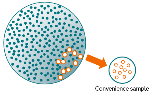

Convenience sampling is when you select values in a population that are most easily available to you. However, convenience sampling can lead to biased samples. A biased sample is one that systematically favors certain outcomes, and therefore, it is not representative of the population from which it is drawn. In the illustration below, there is a particular characteristic that varies depending on where or when an observation is collected (the shading could represent spatial or temporal variation, for example).

- Instead of randomly selecting wafers, the quality team inspects the first 50 wafers produced in the morning run. These wafers are easy to access but might not represent the entire day’s production, especially if defects vary by time of day or equipment conditions.
- The researcher uses samples only from the most recent batch. Because there is potentially some variability from batch to batch, these samples might not be representative of the population she is interested in testing.
- The engineer takes samples from the most accessible location, such as dipping a container in the top of tank or using the bottom drain to collect a sample. In both cases, the samples might not represent the entire tank’s contents, especially if the liquid is layered or settling occurs.
However, convenience sampling is widely used because it can be unrealistic or very expensive to collect a simple random sample. If that’s the case, you must make the non-trivial assumption that the sample that you obtain represents the population of interest, and you must believe that the process that generates the data is stable over time.
