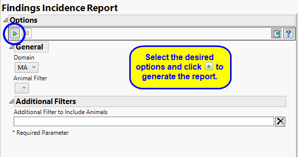

Report Options
General
Use the Domain to specify whether the data is coming from the MA or MI domain.
Filtering the Data:
Filters enable you to restrict the analysis to a specific subset of animals, based on values within variables.
See Select saved animal filter and Additional Filter to Include Animals for more information.
