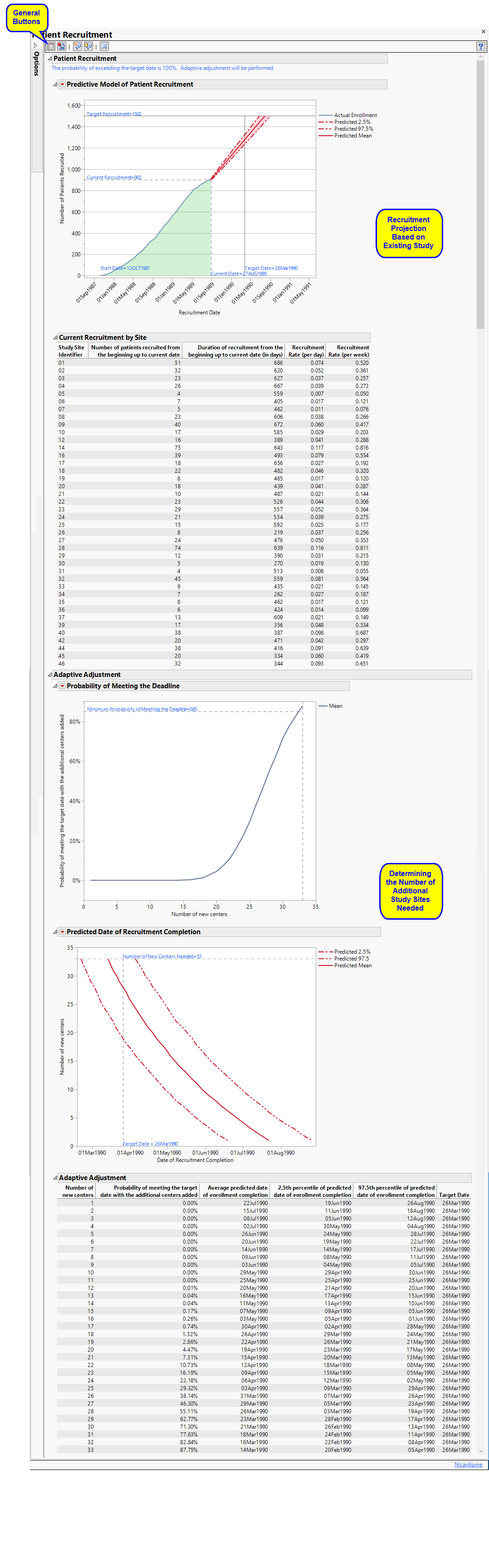

The report consists of the following elements:

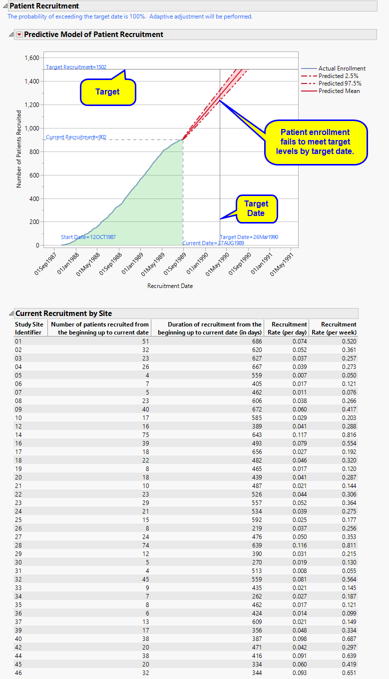

Patient Recruitment
Displays recruitment history and predictions.
This section contains the following
| • | One plot showing patient recruitment over time along with the projected recruitment, based on recruitment history and assuming the number of study remains the same. Target recruitment numbers and deadline are indicated. To meet study requirements, projected enrollments must reach target levels before the deadline. |
In this example, projections suggest that, given the established number of study sites and rate of recruitment, the study will fail to recruit the desired number of subjects by the target date.
| • | One table summarizing recruitment statistics. |
Note: When predicted subject enrollment is insufficient, as shown in this example, the Adaptive Adjustment protocol is invoked.

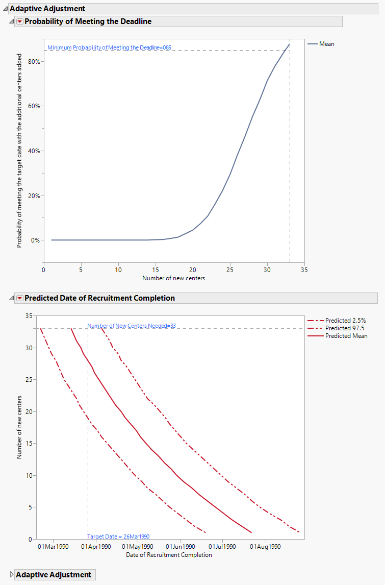

Adaptive Adjustment
Displays number of additional study centers needed to meet the recruitment deadline and the predicted date of completion.
Note: This section is displayed only when recruitment is predicted to be insufficient.
The Adaptive Adjustment section contains the following elements:
| • | One plot showing the number of additional study centers needed to achieve the minimum acceptable probability of meeting recruitment goal by the target deadline. |
In this example, a minimum of 14-15 additional centers are needed.
| • | One plot showing the expected date of completion, given different numbers of additional centers. |
In this example, the predicted date of completion is met only by the addition of 14-15 new centers.
| • | One table summarizing the adjustment statistics. |
General
| • | Click to view the associated data tables. Refer to Show Tables/View Data for more information. |
| • | Click to open and view the Subject Explorer/Review Subject Filter. |
| • | Click to specify Derived Population Flags that enable you to divided the subject population into two distinct groups based on whether they meet very specific criteria. |
| • | Click the arrow to reopen the completed report dialog used to generate this output. |
| • | Click the gray border to the left of the Options tab to open a dynamic report navigator that lists all of the reports in the review. Refer to Report Navigator for more information. |

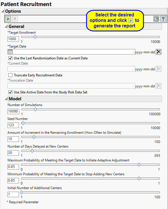

Report Options
Establishing Model Parameters
The first step in setting up the predictive model is to specify the how many patients are needed and the time needed to recruit them.
Use the Target Enrollment and Target Date options, respectively, to specify the total number of subjects needed across all study sites and the desired start date for the study.
This report uses current patient recruitment as the basis for predicting how successful you will be at recruiting
Use the Last Randomization Date as Current Date, Current Date, Truncate Early Recruitment Data, Truncation Date, Use Site Active Date from the Study Risk Data Set
Options
Number of Simulations, Seed Number, Amount of Increment in the Remaining Enrollment (How Often to Simulate), Number of Days Delayed at New Centers, Maximum Probability of Meeting the Target Date to Initiate Adaptive Adjustment, Minimum Probability of Meeting the Target Date to Stop Adding New Centers, Initial Number of Additional Centers
to generate a standardized
to specify
