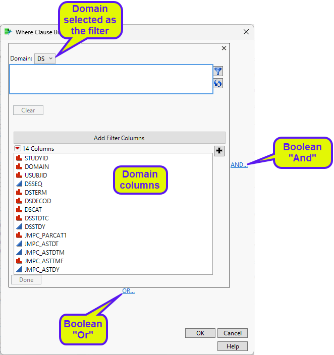

The Where Clause Builder opens.

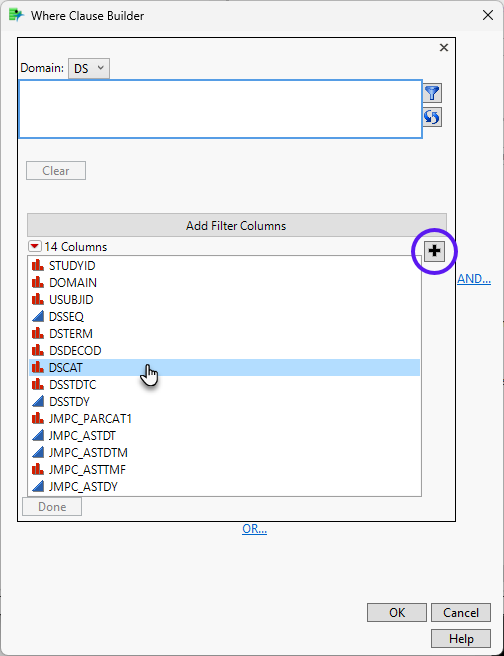

The DS domain is automatically selected as the domain. All of the columns in the domain are listed and are available for selecting.
| 8 | Double-click on a column to select that column. In this example, we select DSCAT and click . |
The column list changes to a list of the different term categories contained in the selected column.
| 8 | Select DISPOSITION EVENT and click . You can see that we have selected 906 observations which account for the 906 subjects in the Nicardipine study. |

You might find it useful to combine multiple simple WHERE expressions into a single, compound WHERE expression. Expressions can be joined either by using Boolean terms, such as AND and OR. Using AND will filter to and include those entities meeting the requirements of all of the specified filters. Using OR will filter to and include those entities meeting any of the specified filters.
Click either or once you have specified your first filter.

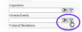

| 8 | Click from the Adverse Events filter |

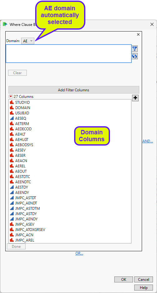

The AE domain is automatically selected as the domain. All of the columns in the domain are listed and are available for selecting.

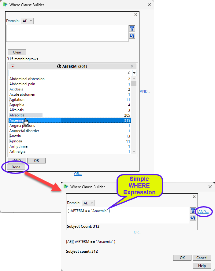

| 8 | Click on a column to select that column. In this example, we select AETERM and click . |
| 8 | Select Anaemia and click to generate the simple WHERE expression. |
| 8 | Click (circled above) to generate a complex WHERE expression. |

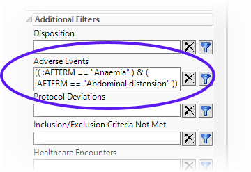

| 8 | Select AETERM and click . |
| 8 | Click . to add the WHERE expression is added to the filter in the report. |
