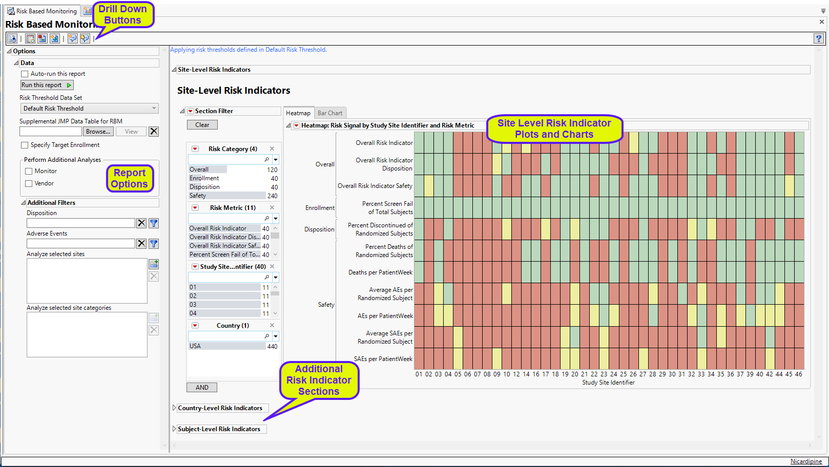

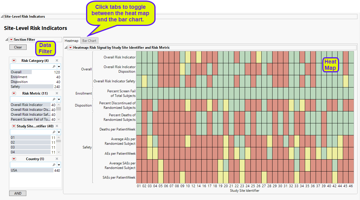

Site-Level Risk Indicators
The Site-Level Risk Indicators section contains the following elements:

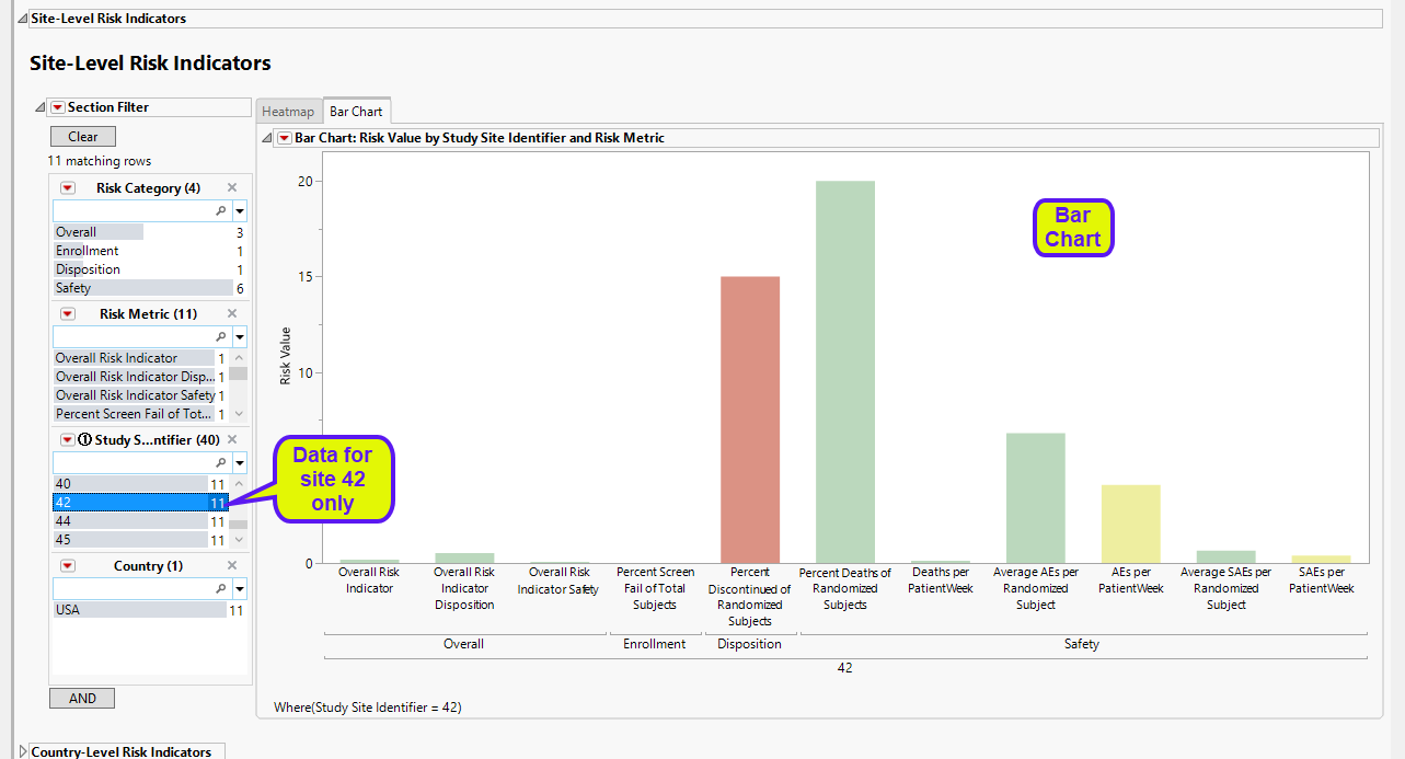

• A heat map of the various risk indicators by Site Identifiers. Individual blocks are colored by the relative severity of each indicator at that site: red = severe, yellow = moderate, green = mild or none. This section enables you to view the distribution of risk indicators across sites, possibly identifying any outliers.
• A Section Filter to filter to data of interest, for example, to risk indicators that belong to a particular site.
• A bar chart showing the risk value for each indicator across the sites. The data in the following bar chart were filtered to site 42 only.

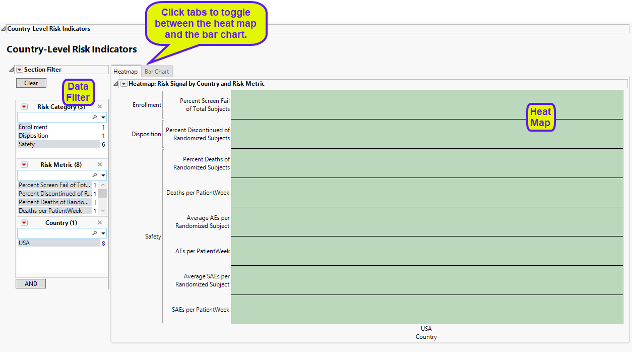

Country-Level Risk Indicators

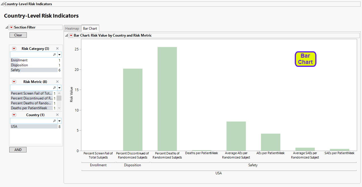

The Country-Level Risk Indicators section contains the following elements:
• A heat map of the various risk indicators by Country Identifiers. Individual blocks are colored by the relative severity of each indicator at that site: red = severe, yellow = moderate, green = mild or none. This section enables you to view the distribution of risk indicators across countries, possibly identifying any outliers.
• Note: All of the trial sites are located within the United States, so only one country is displayed.
• A Section Filter to filter to data of interest, for example, to risk indicators that belong to certain risk categories.
• A bar chart showing the risk value for each indicator. across the sites.

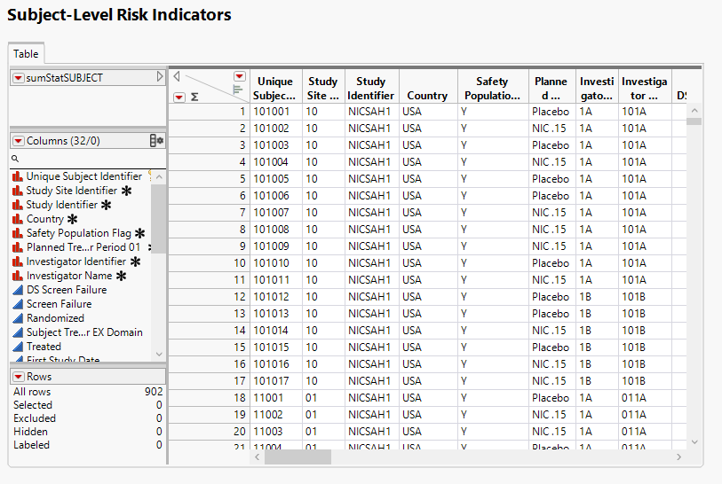

Subject-Level Risk Indicators
The Subject-Level Risk Indicators section contains the following elements:
• A table listing the risk indicators of each subject.

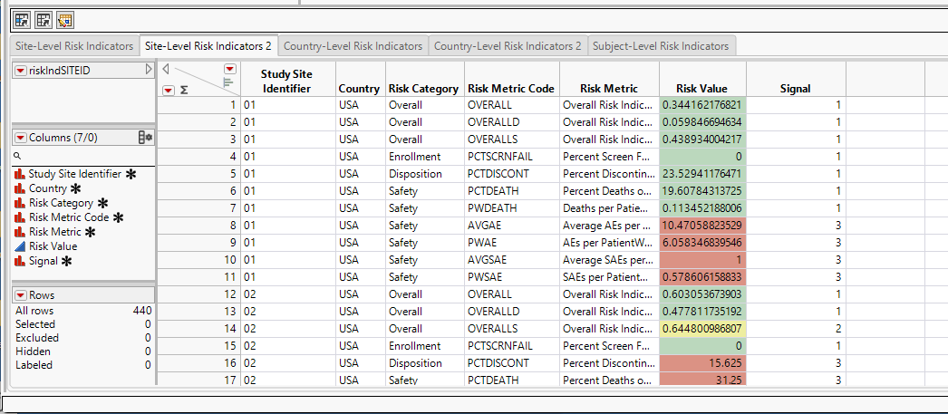

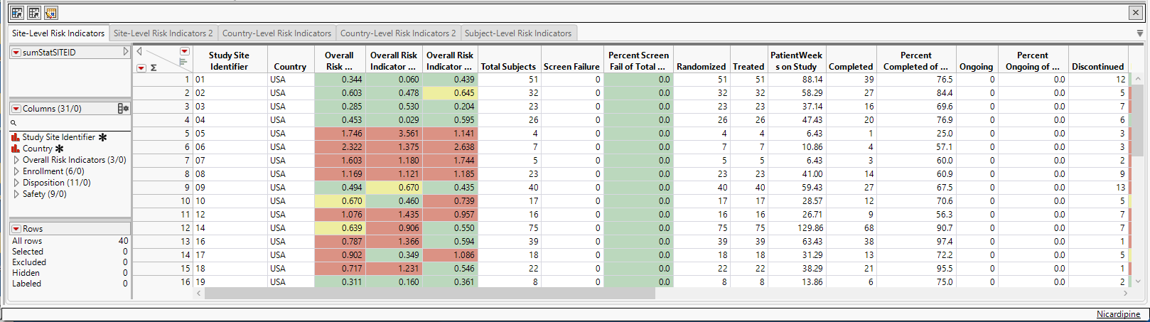

• Site-Level Risk Indicators: This data table displays risk indicators summarized at the site level. Risk indicators with defined thresholds are colored in green, yellow, or red. Each site-level risk indicator is in a separate column. This is a "short" and "wide" data table.
• Site-Level Risk Indicators 2: This data table displays risk indicators summarized at the site level. It contains only those risk indicators that have a defined threshold and they are colored in green, yellow, or red. All the risk values are stacked in the same column: Risk Value. The risk indicator name is stored in the Risk Metric column. This is a "long" and "narrow" data table.

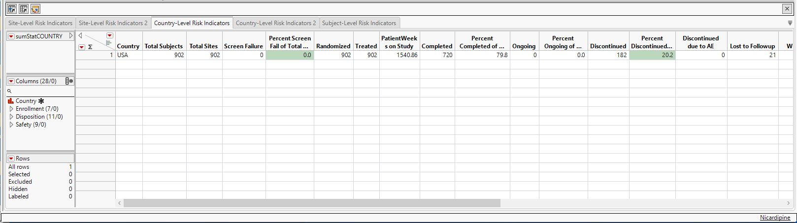

• Country-Level Risk Indicators: This data table displays risk indicators summarized at the country level. Risk indicators with defined thresholds are colored in green, yellow, or red. Each country-level risk indicator is in a separate column. This is a "short" and "wide" data table.
• Country-Level Risk Indicators 2: This data table displays risk indicators summarized at the country level. It contains only those risk indicators that have a defined threshold and they are colored in green, yellow, or red. All the risk values are stacked in the same column: Risk Value. The risk indicator name is stored in the Risk Metric column. This is a "long" and "narrow" data table.
