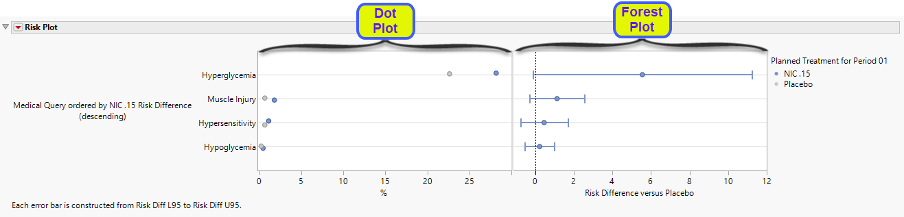

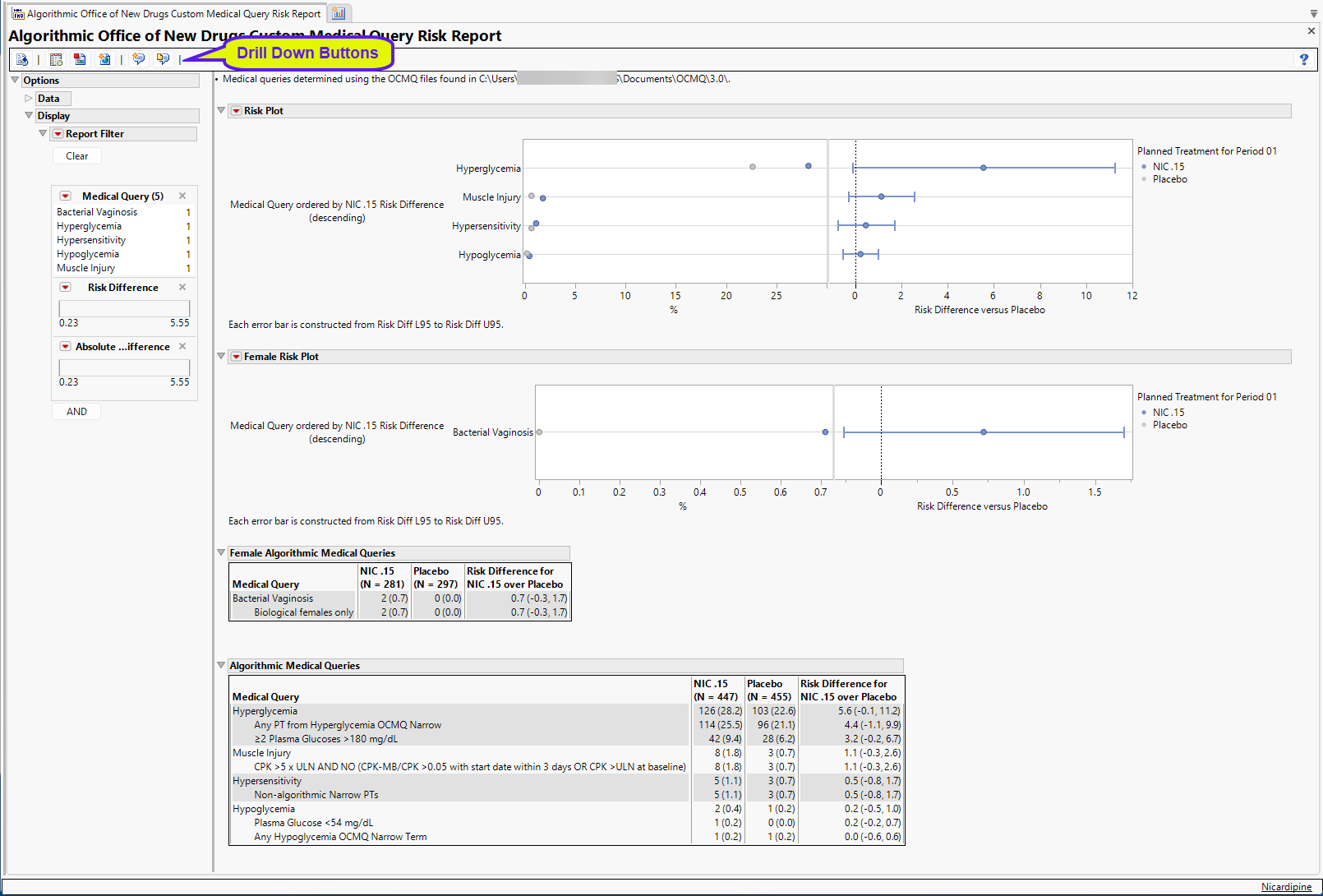

Risk Plot
There are two plots shown here. Medical queries are shown on the y axis. The dot plot on the left of each group shows the percentile occurrence of subjects in each arm exhibiting the queries. The Forest plot on the right of each group shows the risk difference for subjects to exhibit events covered by each query.
Forest Plots display relative strength of treatment effects as horizontal lines representing the 95% confidence interval of the effect observed in that trial. The confidence interval is normally for the relative likelihood of a given nominal-level outcome for the intervention group compared to the control group. In this example, the forest plot shown below, represents the risk difference for developing the specified event relative to exposure to Nicardipine.
Note: When you select either Relative Risk or Odds Ratio as the Risk Measurement, the scale on the x-axis of the Forest plot changes from linear to a log scale.

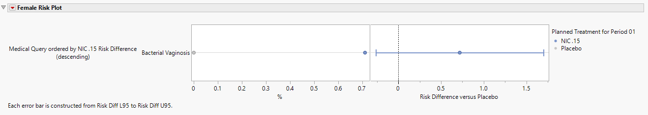

Sex-specific Risk Plot(s)
These plots are like the plots shown above but display sex-specific algorithmic OCMQs only. They are surfaced only when the Display sex specific algorithmic OCMQs separately option is checked.
In this example, a plot for female-specific algorithmic OCMQs is shown. A male-specific plot would also have been shown if any of the subjects had exhibited male-specific events.

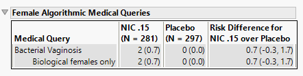

Sex-specific Algorithmic Medical Queries Table(s)
This table is like the table shown above but lists sex-specific algorithmic OCMQs only. It is surfaced only when the Display sex specific algorithmic OCMQs separately option is checked.
In this example, a table for female-specific algorithmic OCMQs is shown. A male-specific table would also have been shown if any of the subjects had exhibited male-specific events.

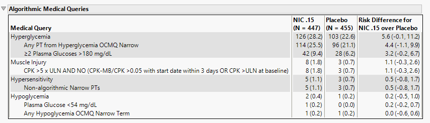

This table lists each query with its associated qualifications, the number (percent) of subjects exhibiting the event by qualification, and the risk difference between the treatment arms.

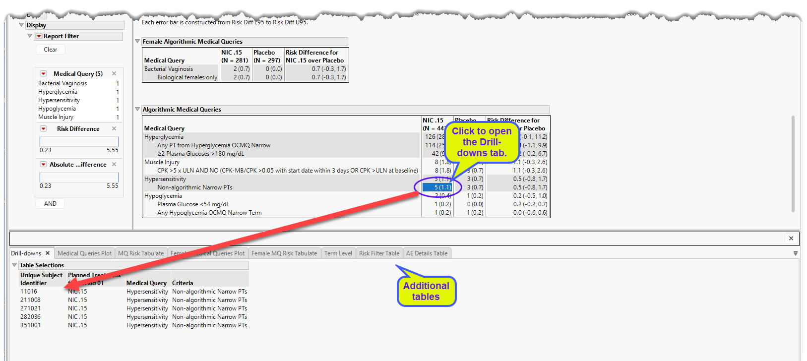

You can click on the subjects displaying specific events described by the medical queries to bring up the Drill-downs tab that provides more details about the specific subjects and medical query along with several additional tables with more details.

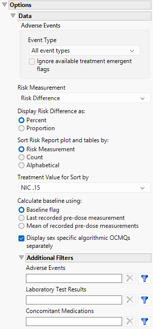

Options
Data
Event Type
Analysis can consider all events or only those that emerge at specific times before, during, or after the trial period. For example, selecting On treatment events as the Event Type includes only those events that occur on or after the first dose of study drug and at or before the last dose of drug (+ the offset for end of dosing).
Ignore available treatment emergent flags
If you choose to ignore available treatment emergent flags, the analysis includes all adverse events that occur on or after day 1 of the study when the event type is Treatment emergent events.
Risk Measurement
Use the Risk Measurement option to specify the measure you want to use for defining risk.
Display Risk Difference as:
Use this widget to specify whether to display the risk difference values as either percentages or proportions.
Sort Risk Report plot and tables by:
Use the Sort Risk Report plot and tables by: widget to specify how the rows in the Risk Report plot and tables are to be sorted.
Treatment Value for Sort by:
Use this widget to specify the treatment value to sort the plots and tables by. This is especially useful when there are multiple treatment regimes. Refer to Treatment Value for Sort by for more information.
Calculate baseline using:
Use this widget to specify how the baseline findings measurements should be calculated. Refer to Calculate baseline using: for more information.
Check this option to display male-specific and female-specific algorithmic OCMQs in separate and distinct plots and tables. When this option is unchecked, sex-specific algorithmic OCMQS are included in the main plot and table.
Additional Filters
These filters let you restrict your analysis to only those subjects that meet specific criteria at the domain level. Applicable domains include Adverse Events (AE), Findings (LB), and Interventions (CM). Filters use JMP WHERE clauses to Select Rows that meet the specified criteria. To use these filters, you must enter the JSL (JMP Scripting Language) expressions that constitute the WHERE clause in the appropriate text box for specific filtering of AEs, Disposition, Findings, and/or Subjects. Note: This is an advanced concept that not only requires some basic knowledge of the JSL where clause syntax (similar to, but different from, SQL), but also an understanding of the exact variables in the tables in the study.
Note: To filter subjects with a specific event, one could also use the Subpopulation Builder on any domain of interest. For example, filter to all subjects that exhibit cardiac failure ( :Customized Query 01 Name == "Cardiac failure" ) and run all reports on those.
