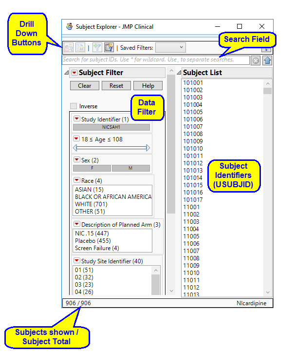

8 Use the Data Filter to select specify criteria for including subjects to explore. Only those subjects meeting the filtering criteria are shown in the subject list.
8 Click to select a subject and use drill down buttons for further analysis. Use Ctrl-click to select multiple subjects. Alternatively, you can enter1 specific USBJIDs in the Search Field and these will automatically be listed in the selectable window.
8 Click to generate patient profiles of the selected subjects.
8 Click to open the Adverse Events Narrative generator.
8 Click to create a subject-specific filter that is applied to all subsequent reports run on the data for the study. Only those patients specified by the filter are carried through the analyses.
8 Click to Manage Subject Filters to delete existing subject filters.
8 Use the drop-down menu to select existing filters for your analyses.
