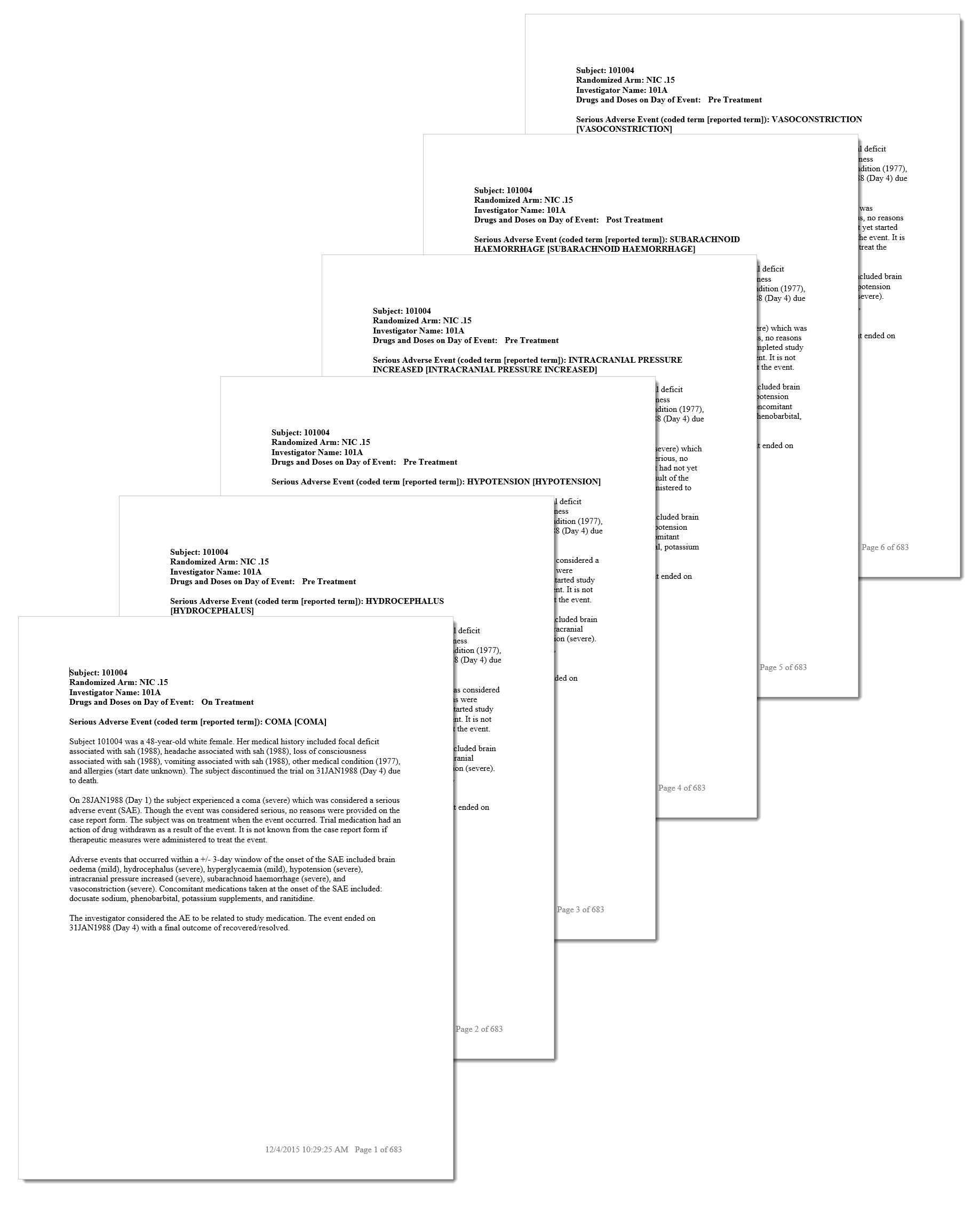

Running this report with the Nicardipine sample setting generates an rtf file containing narratives like the one below.
The narrtext dataset output by the AE Narrative report contains variables that are used by the template to create the narrative. Refer to The Adverse Events Narrative NarrText Derivations Table for additional details about these variables and their derivations.
In general, a narrative for a single Adverse Event is included on each page. In the example shown here, subject 101004 experienced 6 adverse events that are described over 6 pages.
Sections of each narrative are as follows:
Paragraph 1 summarizes demographic and medical history. You have the option to include reported or coded medical history terms. The first exposure to study drug is reported as well as the subject's completion status. The appropriate disposition term from DS should be provided on the General tab of the Adverse Events Narrative dialog.
Paragraph 2 describes the particular AE of interest, such as the date of occurrence, whether it met the definition of serious or not and the particular criteria (all non-serious AEs are considered Other Significant Adverse Events) and the action taken with study medication as the result of the event. Other details include the dose of drug taken at the time of the event and how long the subject was at this dose. If the event occurred between the first and last day of dosing (inclusive), and a subject received a dose of 0 or no drug taken at the time, then this is considered a dose interruption. Events before the first day of dosing are considered "Pre-treatment", while those after the last day of dosing are considered "Post-treatment". If a subject has no records in EX with a dose > 0, then they are considered "Untreated". If more than one dose is taken on the day on which the event begins, the maximum is reported. Concomitant medications were used to treat the event are reported (based on AECONTRT). Should AECONTRT = Y, the narrative code attempts to identify these medications by looking for medications with indications that match the reported term of the event.
Paragraph 3 reports on other adverse events that occur close to the start of the event of interest. The severity or toxgrade of these events are reported. Only unique instances based on AE term and severity are printed. For example, if a subject has two mild headaches in a six-day , this is printed only once. Any medications that are taken at the time of the event are reported. The Options tab enables you to include the indication for each medication. Similar to the reporting of nearby AEs, only unique concomitant medications (and indications, if requested) are reported.
Paragraphs 4-6 (if requested from the Labs, ECG, or Vital Signs sections) provide a brief description of findings results that provide further insight to the adverse event. Baseline findings can be included to understand how a subject began the study. Baseline flags reported in the data are considered for defining baseline. Otherwise, the program determines baseline (of all records, or those flagged as baseline from the data). For laboratory measurements, the last measurement on or before the start of dosing (day 1) is considered baseline. For ECG and Vital Signs, the last day of measurements on or before the start of dosing (day 1) is considered baseline. If multiple measurements are reported on this day, all measurements are reported. You also have the ability to report on post-baseline findings that occur on, before, or after the event. Findings reporting can be customized using WHERE statements (see The SAS WHERE Expression) or the option to subset those tests or results that are of interest.
The final paragraph describes the causal effect of the study medication to the AE and whether the event was resolved.

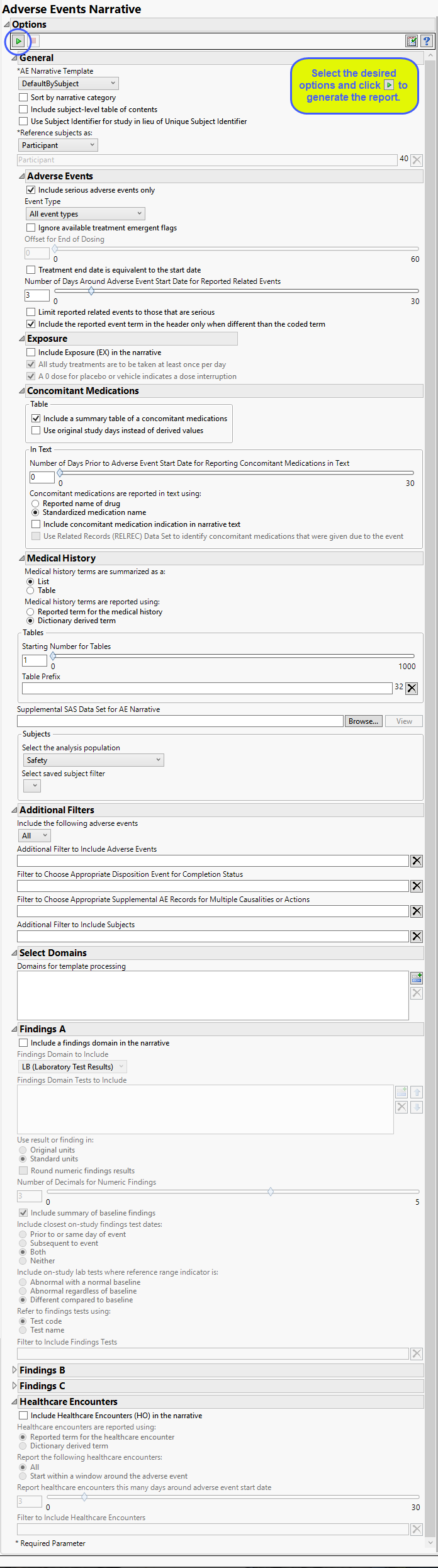

Report Options
Specific documentation for each of the options can be viewed by clicking on the following links:
General Options
Use the AE Narrative Template option to select the template for the narrative. Templates enable you to customize the narrative in a variety of layouts and/or styles. The templates are read by JMP Clinical at run time and available for selection when creating the final document. The result of this design enables very customizable output that can be altered and/or extended as appropriate for different types of studies or specific regulatory requests.
Check the Sort by narrative category option to sort the narrative by category of fatal adverse events, serious adverse events, adverse events leading to discontinuation, or adverse events of special interest.
You can also Include subject-level table of contents in the narrative.
The Use Subject Identifier for study in lieu of Unique Subject Identifieroption enables you to use the subject identifier for study (SUBJID), if it is available, in lieu of unique subject identifier (USUBJID) in the narrative text. If SUBJID is not available, USUBJID is used as normal.
Use the Reference subject as: option to specify the term to use when referencing subjects in the narrative.
