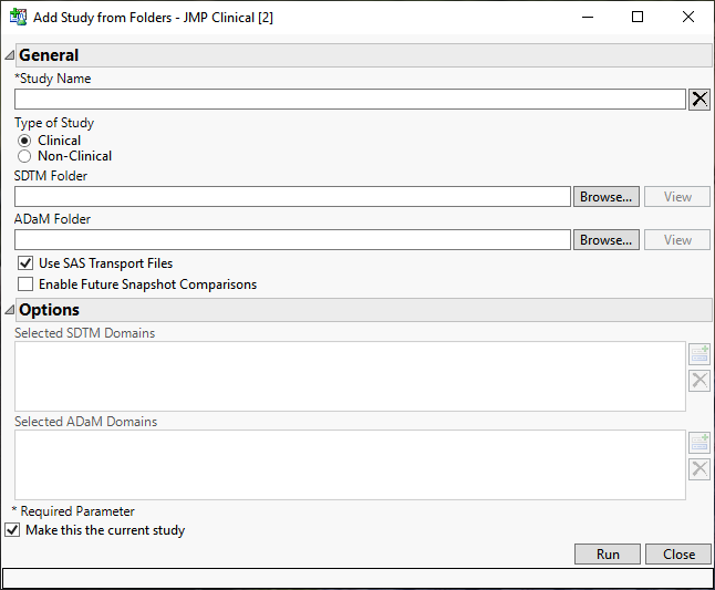

8 Click to open the dialog:
Note: If your JMP Clinical software has been configured for SAS Drug Development, clicking expands a drop-down menu. Select From Folders from the drop-down menu to open the Add Study dialog.
8 Specify the desired options and click .
The following options are available. Links to specific documentation for each of the options are provided in the following table:

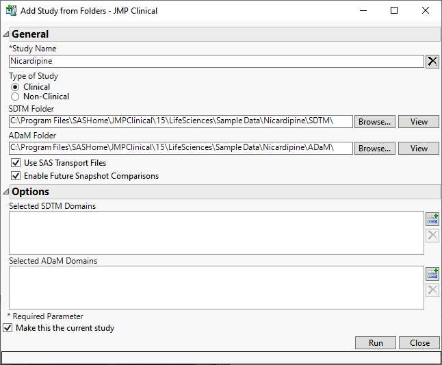

Example: Adding the Nicardipine Study
JMP Clinical ships with the data from a Nicardipine study. The data files are located in the Sample Data in your Installation directory (typically C:\Program Files\SASHome\JMPClinical\15\LifeSciences\Sample Data\Nicardipine). In this example, we add a clinical study we call Nic1.
8 Click to open the Add Study dialog.
8 Specify the name of the study.
8 Click the Clinical radio button to specify the type of study.
8 Specify the file paths to the SDTM and ADaM folders either by typing the path directly or clicking
8 Check the boxes to enable use of SAS transport files and future snapshot comparisons.
The completed dialog appears as follows:
8 Click to add the study.

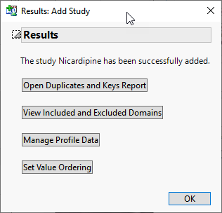

When a study has been successfully added, the Results: Add Study window opens:
Options
Information
• Opens a PDF report listing all of the keys and duplicates in each domain in the study.
• Opens a PDF listing all of the domains included in or excluded from the study.
• Opens the Manage Profile Data window.
• Opens the Set Value Order and Color in Studies window.
