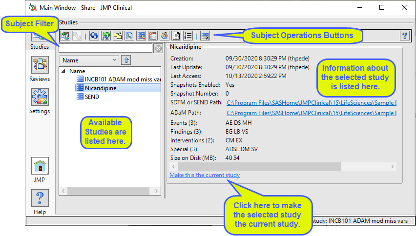

All study additions and manipulations are done on the Studies tab shown below:

Available Studies
All of the registered studies available to you are listed here. Studies can be sorted by various criteria in ascending or descending order.

Study Information
Information about the selected study is shown in the panel on the right side of the window. This includes the date the study was created, when it last updated and when it was last accessed. Additionally, the location of the study data within your file structure is shown along with a list of the domains that make up your study data. In the Nicardipine study shown above, there are 3 events domains (AE, DS, and MH), 3 findings domains (EG, LB, and VS) 2 interventions domains (CM and EX), and three special domains (ADSL, DM, and SV).
