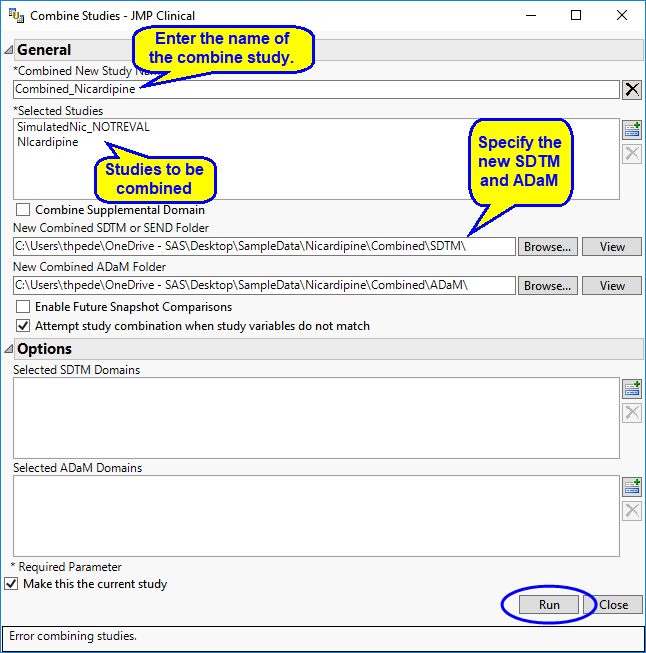

To combine two studies:

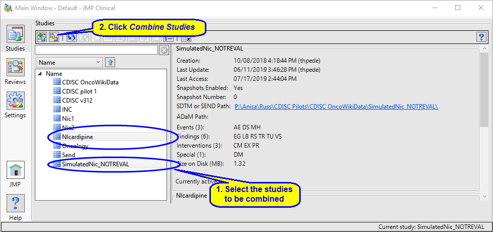

| 8 | Select the two studies to be combined and click . |
| 8 | Specify the names of the new study and the SDTM and ADaM folders and click . |

Attempt study combinations when study variables do not match |
Note: In cases where there are variables that cannot be combined, this report generates a report listing those variables. |
| 8 | Specify the desired options and click . |

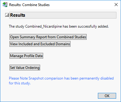

When the combination process is complete, the following Results window appears.

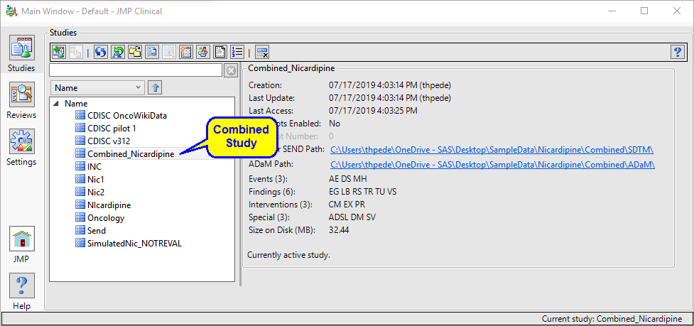

| 8 | Click to complete the process and add the combined study to the main window, as shown below. |
