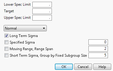

The Capability Analysis window appears when you select the Capability Analysis option from the red triangle menu next to the name of the analysis variable and the corresponding column does not contain a Spec Limits column property. For an example of using this window, see Example of Capability Analysis.
Figure 2.12 Capability Analysis Window
<Distribution type>
Note: If you specify a distribution other than Normal, the selections for sigma are ignored. The fitted distribution report contains a Quantile Sigma report that calculates capability indices from the quantiles of the fitted distribution. See Capability Indices for Nonnormal Distributions. For more information about the relationship between the parameters in the Parameter Estimates report and the expected value and variance of the fitted distributions, see Continuous Fit Distributions and Discrete Fit Distributions.
For more information about the calculations for the long term sigma, moving range sigma, and the short term sigma, see Variation Statistics.
Note: By default, the capability indices in the Long Term Sigma report use the Cp labeling that is used in the other sigma reports. To use Ppk labeling in the Long Term Sigma report, select the File > Preferences > Platforms > Distribution > PpK Capability Labeling preference.
