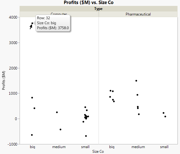

Select Graph > Graph Builder. The Graph Builder window appears.
Click Profits ($M) and drag and drop it into the Y zone.
Click Size Co and drag and drop it into the X zone.
5.
Click Type and drag and drop it into the Group X zone.
Figure 3.98 Graph of Company Profits
6.

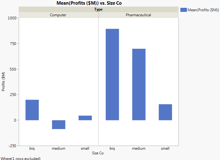

Select the outlier, then right-click and select Rows > Row Exclude. The point is removed, and the scale of the graph automatically updates.
Figure 3.99 Graph with Outlier Removed
Return to the Companies.jmp sample data table that has the data point excluded. See Discover the Relationship.

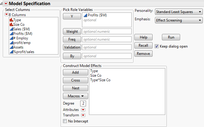

Select Analyze > Fit Model.
Select Profits ($M) and click Y.
Select both Type and Size Co.
5.
Click the Macros button and select Full Factorial.
6.
7.
Select the Keep dialog open option.
Figure 3.100 Completed Fit Model Window
8.
Click Run. The report window shows the model results.

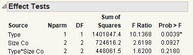

The Effect Tests report (see Figure 3.101) shows the results of the statistical tests. There is a test for each of the effects included in the model on the Fit Model window: Type, Size Co, and Type*Size Co.
Figure 3.101 Effect Tests Report
First, look at the test for the interaction in the model: the Type*Size Co effect. Figure 3.99 showed that the pharmaceutical companies appeared to have different profits between company sizes. However, the effect test indicates that there is no interaction between type and size as it relates to profit. The p-value of 0.218 is large (greater than the significance level of 0.05). Therefore, remove that effect from the model, and re-run the model.
In the Construct Model Effects box, select the Type*Size Co effect and click Remove.
Click Run.
