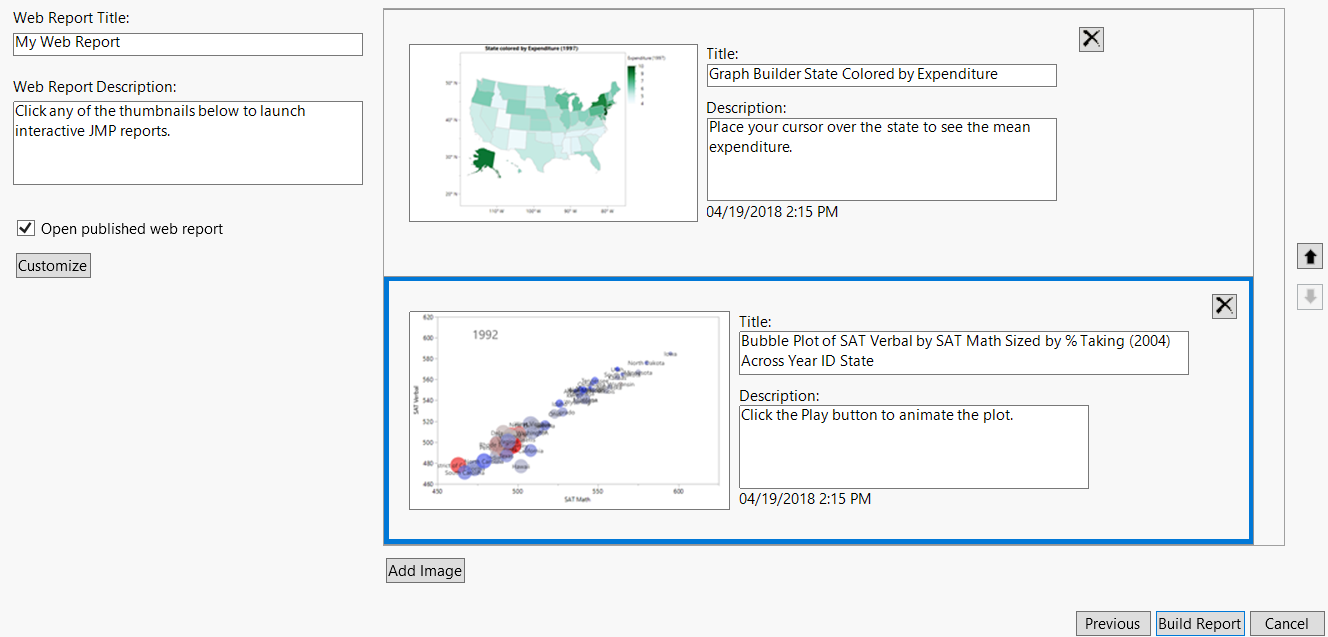

Note: If you selected one report, you have the option of generating an index page. The index page shows a thumbnail of the report. You click the thumbnail to view the report. Figure 9.4 shows an example.
Figure 9.3 Customizing the Web Report
Click Add Image to append an image to the bottom of the report.
Enter SAT By Year Reports in the Web Report Title box.
Click Build Report.

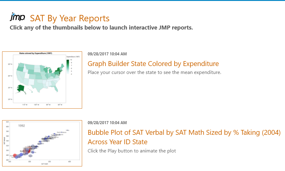

Figure 9.4 Web Report
Click on one of the thumbnails to open the report in an interactive web page. See https://www.jmp.com/support/help/InteractiveHTML/14/ShareJMPReports.shtml for details about working with interactive reports.
