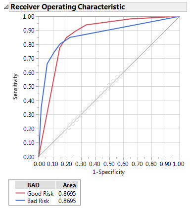

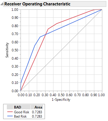

Next, compare the models using the Model Comparison platform to compare the two sets of formulas that you created in step 4 and step 3.
Select Analyze > Predictive Modeling > Model Comparison.
Select Prob(BAD==Good Risk), Prob(BAD==Bad Risk), Prob(BAD==Good Risk) 2, and Prob(BAD==Bad Risk) 2 and click Y, Predictors.
Click OK.
Figure 4.24 Measures of Fit from Model Comparison
