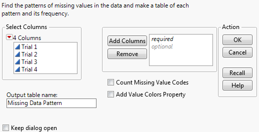

With your data table open, select Tables > Missing Data Pattern.
Click Add Columns.
Select Count Missing Value Codes to count missing value codes as missing values.
5.
Select Add Value Colors Property to consistently color columns that contain 0 or 1 (missing value indicators).
6.

Select Tables > Missing Data Pattern.
Figure 3.18 The Missing Data Pattern Window
Click Add Columns.
5.

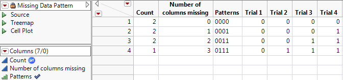

Figure 3.19 A Missing Data Pattern Table
Figure 3.19 shows the following patterns:
Row 1 shows that there are two instances where all rows in Trial 1, Trial 2, Trial 3, and Trial 4 have no missing values.
The Count column is assigned the frequency role. If you now use the Missing Data Pattern data table to run an analysis, JMP automatically uses Count as a frequency. For details, see Assign a Preselected Analysis Role in The Column Info Window.
