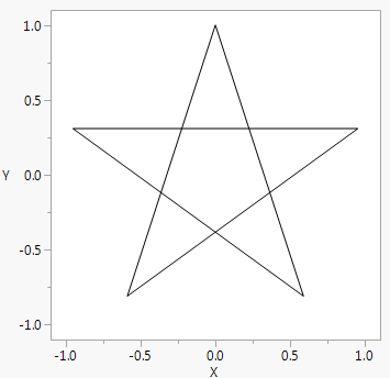

Line() draws lines between points.
win = New Window( "Five-Point Star",
Graph Box(
Frame Size( 300, 300 ),
X Scale( -1.1, 1.1 ),
Y Scale( -1.1, 1.1 ),
Line(
{Cos( 1 * Pi() / 10 ), Sin( 1 * Pi() / 10 )},
{Cos( 9 * Pi() / 10 ), Sin( 9 * Pi() / 10 )},
{Cos( 17 * Pi() / 10 ), Sin( 17 * Pi() / 10 )},
{Cos( 5 * Pi() / 10 ), Sin( 5 * Pi() / 10 )},
{Cos( 13 * Pi() / 10 ), Sin( 13 * Pi() / 10 )},
Figure 12.10 Using Lines to Draw a Star

The star example could also be drawn this way. Note that the script must include the full Matrix( {...} ) notation rather than [ ] shorthand because the entries are expressions. The following example uses the Matrix() function.
Graph Box(
Line(
Matrix(
{ // the x coordinates
Cos( 1 * Pi() / 10 ), Cos( 9 * Pi() / 10 ), Cos( 17 * Pi() / 10 ),
Cos( 5 * Pi() / 10 ), Cos( 13 * Pi() / 10 ), Cos( 1 * Pi() / 10 )}
Matrix(
{ // the y coordinates
Sin( 1 * Pi() / 10 ), Sin( 9 * Pi() / 10 ), Sin( 17 * Pi() / 10 ),
Sin( 5 * Pi() / 10 ), Sin( 13 * Pi() / 10 ), Sin( 1 * Pi() / 10 )}
