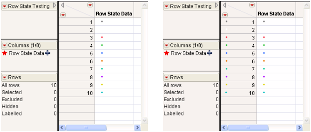

A row state column is a dedicated column that stores row state information, but does not put the information into effect. You can then use For Each Row to put the row state column into effect. For more information about row state columns, see Row State Columns in the Using JMP book.
dt = New Table( "Row State Testing" );
dt << New Column( "Row State Data", Row State, Set Formula( Color State( Row() ) ) );
dt << Add Rows( 10 );
For Each Row( Row State() = :Row State Data );
This action replaces any row states in effect with the row state combination from the row state column. For details about how to change selected attributes of a row state without changing or canceling others, see Set One Characteristic and Cancel Others.

Marker State( Marker Of( Row State( 4 ) ) )
In the following example, row state values are prepared ahead and passed to the Marker routine, along with matrices of coordinates.
dt = New Table( "Artificial CP and CA data",
Add Rows( 26 ),
New Column( "cover_cp",
Numeric,
"Continuous",
Formula( Random Uniform() / 100 + 0.94 )
New Column( "cover_ca",
Numeric,
"Continuous",
Formula( Random Uniform() * 0.04 + 0.94 )
New Column( "p", Numeric, "Continuous", Formula( Random Uniform() ) )
dt << Run Formulas;
greenMark = Combine States( Marker State( 2 ), Color State( 4 ) );
redDiamond = Combine States( Marker State( 3 ), Color State( 3 ) );
New Window( "CP and CA Comparisons",
Graph Box(
Title( "CP and CA Comparison" ),
FrameSize( 400, 350 ),
X Scale( 0, 1 ),
Y Scale( 0.94, 1 ),
For Each Row(
Marker( greenMark, {p, cover_cp} );
Marker( redDiamond, {p, cover_ca} );
Figure 9.16 Example of Row States Values and Matrices
