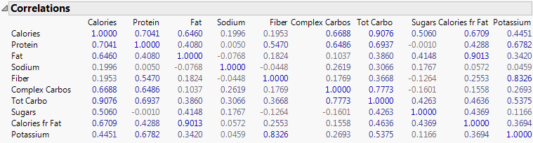

Select Analyze > Multivariate Methods > Multivariate.
Figure 4.115 Correlations Report

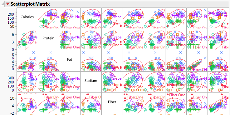

The density ellipses in the Scatterplot Matrix further illustrates relationships between variables. Figure 4.116 shows a portion of the plot.
Figure 4.116 Portion of the Scatterplot Matrix

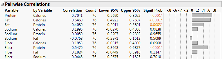

Select Pairwise Correlations from the Multivariate red triangle menu to display the Pairwise Correlations report.
Figure 4.117 Portion of the Pairwise Correlations Report

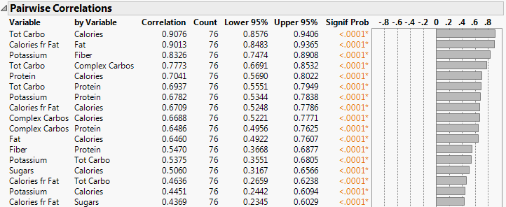

To quickly see which pairs are highly correlated, right-click in the report and select the Sort by Column, Signif Prob, Ascending check box, and then click OK.
The most highly correlated pairs appear at the top of the report. The small p-values for the pairs indicate evidence of correlation. The most significant correlation is between Tot Carbo (total carbohydrates) and Calories.
