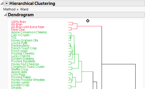

The Hierarchical Clustering report appears. Figure 4.119 shows a portion of the report. The clusters are colored according to the data table row states.
Figure 4.119 Portion of the Hierarchical Clustering Report

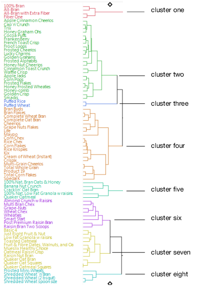

Select Color Clusters from the Hierarchical Clustering red triangle menu.
Figure 4.120 Colored Clusters

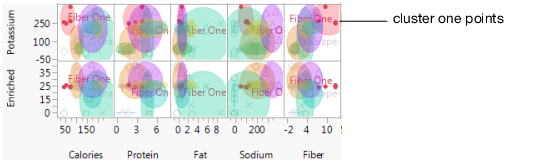

Figure 4.121 Similar Cereals in Cluster One
Figure 4.122 Selecting a Cluster

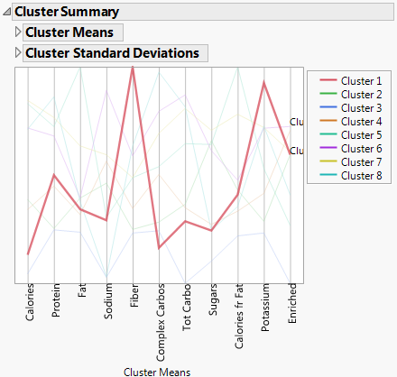

To see the similar characteristics in the cluster, select Cluster Summary from the red triangle menu.
Figure 4.123 Cluster Summary
Figure 4.124 Cluster One Characteristics
