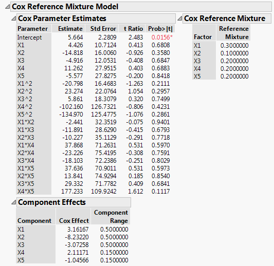

Figure 3.39 Cox Reference Mixture Window
8. Enter the reference mixture points shown in Figure 3.39.
9. Click OK.
Figure 3.40 Cox Mixtures
The report shows the parameter estimates for the Cox mixture model, along with standard errors, and hypothesis tests. The reference mixture appears on the right. The component effects appear below, along with the range.
