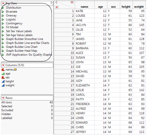

To automatically complete various analyses and tasks, you can create a JSL script and save it to the data table (Figure 4.60). For more information about writing data table scripts, see Table Scripts in the Scripting Guide.

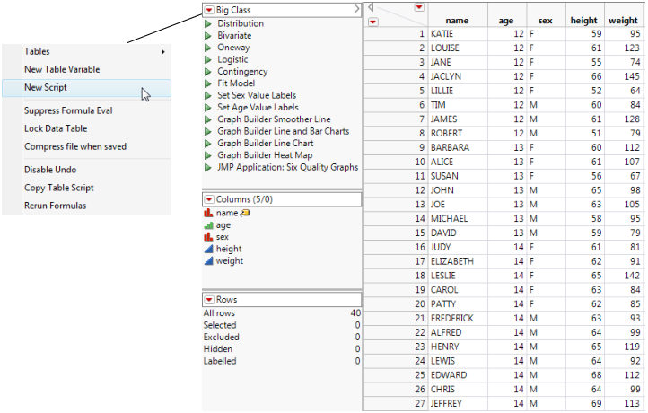

Write a JSL Script for the Data Table
To add a script to a data table using JSL
1. Click the red triangle to the left of the data table name in the Table panel.
Figure 4.61 Creating a Script
2. Select New Script.
3. Give the script a name by typing it into the box beside Name.
4. Add the script by entering JSL code into the box beside Script.
5. Perform one of the following actions:
– If you want to run the JSL Debugger on the script to check it for errors, click Debug Script.
– If you are finished editing the script, click OK. The script appears in the Table panel and the window closes.
– If you are not finished editing the script and want to save it, click Save. The script appears in the Table panel and the window remains open for further editing.
– If you want to run the script, click Run.
