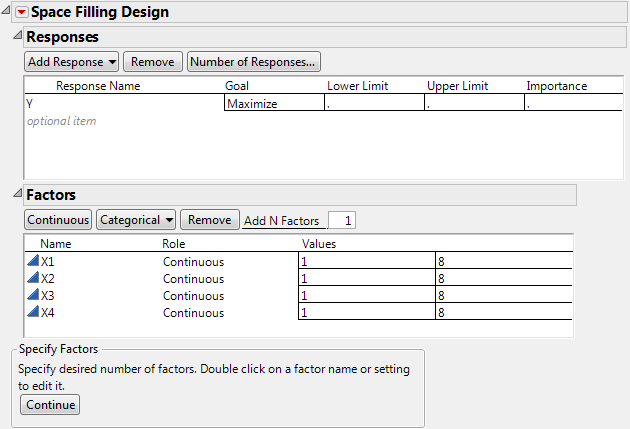

3. Alter the factor level values, if necessary. Figure 21.10 shows adding two factors to the two existing factors and changing their values to 1 and 8 instead of the default –1 and 1.
Figure 21.10 Space-Filling Dialog for Four Factors

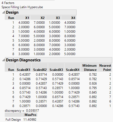

5. In the design specification dialog, specify a sample size (Number of Runs). This example uses a sample size of eight.
6. Click Latin Hypercube (Figure 21.7). Factor settings and design diagnostics results appear similar to those in Figure 21.11, which shows the Latin Hypercube design with four factors and eight runs.
Note: The purpose of this example is to show that each column (factor) is assigned each level only once, and each column is a different permutation of the levels.
Figure 21.11 Latin Hypercube Design for Four Factors and Eight Runs with Eight Levels
