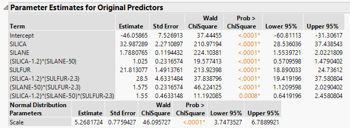

Figure 3.34 Parameter Estimates From Generalized Regression Report

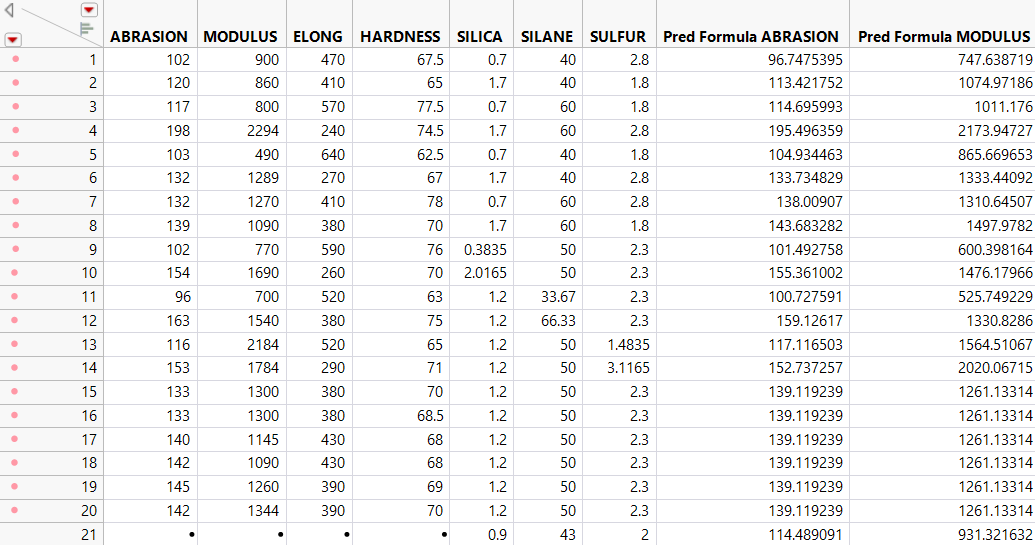

All of the prediction columns for the new row are automatically calculated.
Figure 3.35 Values for New Row

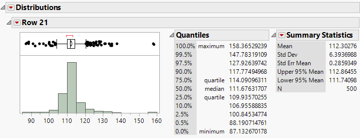

Figure 3.36 Distribution Report
The Distribution Report in Figure 3.36 contains information about the distribution of the predicted values of ABRASION from each bagged model. The final prediction of ABRASION for the new observation is 112.3, which is the mean of all the M bagged predictions. This prediction has a standard error of 6.39. You can also create confidence intervals for the new prediction using the quantiles. For example, a 95% confidence interval for the new prediction is 100.85 to 127.93.
