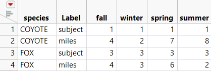

Figure 6.18 Transpose Using a By Group
The transposed table contains values that have been transposed in groups.
