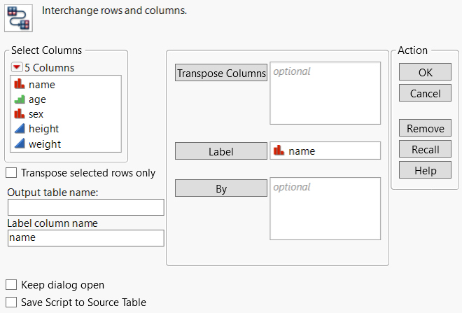

Figure 6.15 Transpose Window
3. Highlight the column name(s) you want to transpose in the Select Columns box on the left.
4. Click Transpose Columns.
5. (Optional) Customize your transposed table further using the additional options.
6. Click OK.
Transpose Options
Select Columns Filter Menu
Contains options to search and filter through columns. See Column Filter Menu in the Get Started section.
Transpose selected rows only
Transposes only rows that are currently highlighted in the active table.
Output table name
(Optional) Specifies the name of the subset table.
Label column name
(Applicable only if you have specified a Label column.) Specifies an alternative name for the Label column. Otherwise, the default column name is Label.
Keep dialog open
Keeps the Transpose window open after you click OK.
Save Script to Source Table
Saves a script to the original data table that enables you to transpose the data again using the same settings.
Transpose Columns
Adds the columns that you want to transpose.
Label
Uses the data from a column in the original table as the column names in the new table. Follow these steps:
1. Highlight a column from the Select Columns box on the left.
2. Click Label. The column name appears in the Label box.
The default column name is Label. You can specify an alternative name for the column using the Label column name option. Only one column is created for each distinct value in the label column. Therefore, if there are duplicate values in the label column, JMP creates only one column for the duplicated value using the value from the last duplicated row.
