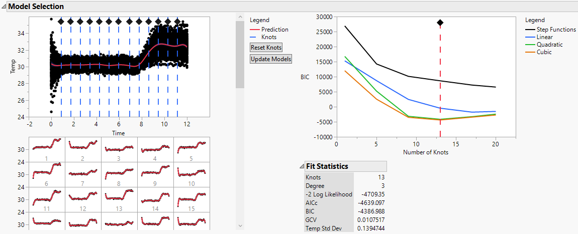

Data preprocessing tools are available in the FDE platform, including several types of transformations for output data and alignments for input data. A functional model is created by fitting a B-spline, P-spline, or Fourier basis model to the data. When a model is fit, functional principal components analysis (functional PCA) is automatically performed on the functional model. Results from the functional PCA, such as the functional principle component scores, are saved to a separate data table and used for feature extraction or dimension reduction.
Figure 15.1 B-Spline Model Selection in FDE
