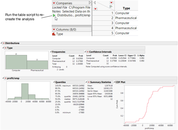

Save the Script to the Data Table and Run It
1. To save this analysis, click the Distributions red triangle and select Save Script > To Data Table. The new script appears in the Table panel.
Figure 7.13 Distribution Script
2. Close the Distribution report window.
3. To re-create the analysis, click the green triangle next to the Distribution script.
Figure 7.14 Running the Distribution Script
Tip: Right-click the table script to view more options.
