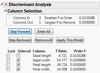

If you select the Stepwise Variable Selection option in the launch window, the Discriminant Analysis report opens, showing the Column Selection panel. Perform stepwise analysis, using the buttons to select variables or selecting them manually with the Lock and Entered check boxes. Based on your selection F ratios and p-values are updated. For more information about how these are updated, see Updating the F Ratio and Prob>F.
Figure 5.4 Column Selection Panel for Iris.jmp with a Validation Set

Stepwise Example
For an illustration of how to use Stepwise, consider the Iris.jmp sample data table.
1. Select Help > Sample Data Library and open Iris.jmp.
2. Select Analyze > Multivariate Methods > Discriminant.
3. Select Sepal length, Sepal width, Petal length, and Petal width and click Y, Covariates.
4. Select Species and click X, Categories.
5. Select Stepwise Variable Selection.
6. Click OK.
7. Click Step Forward three times.
Three covariates are entered into the model. The Smallest P to Enter appears in the top panel. It is 0.0103288, indicating that the remaining covariate, Sepal length, might also be valuable in a discriminant analysis model for Species.
Figure 5.5 Stepped Model for Iris.jmp
