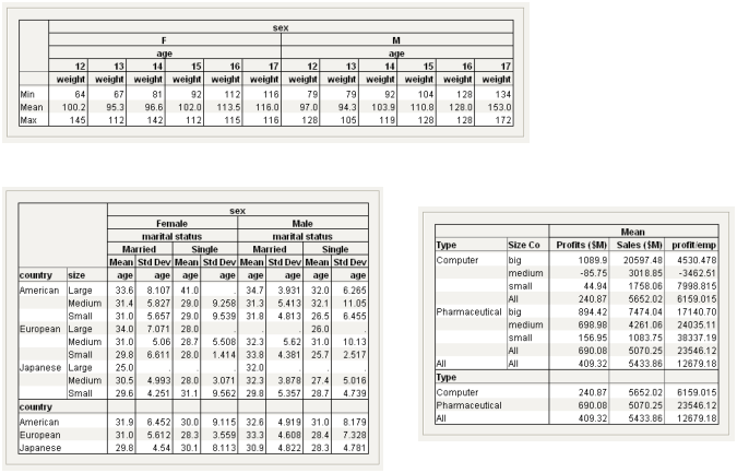

Use the Tabulate platform to interactively construct tables of descriptive statistics. The Tabulate platform is an easy and flexible way to present summary data in tabular form. Tables are built from grouping columns, analysis columns, and statistics keywords.
Figure 9.1 Tabulate Examples
