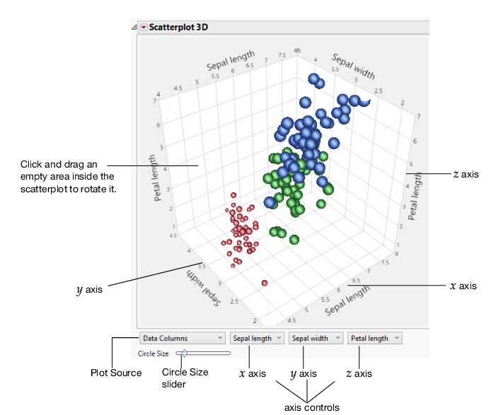

To produce the 3D scatterplot shown in Figure 9.4, follow the instructions in Example of a 3D Scatterplot.
The Scatterplot 3D report shows a three-dimensional spinnable view of your data. See Figure 9.4. In the launch window, you select the variables and then create the report. The variables are displayed on the 3D scatterplots’ x, y, and z axes. Up to three variables can be displayed at a time.

Figure 9.4 Example of Information Displayed on the Scatterplot 3D Report

Plot source
The plot source box indicates the source of the data in the plot.
Circle Size slider
Click and drag the Circle Size slider to resize the balls while maintaining their relative sizes.
Note: The Circle Size slider appears only if you have specified a Weight variable.
Axis controls
Select which variable appears on each axis. Choose the Other option to add a new variable.
Next Axis Set
Cycles through the axis controls for any hidden variables. See Change Variables on the Axes.
Note: The Next Axis Set button appears only if your analysis contains more than three variables.
