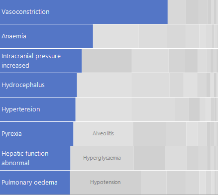

Packed
This bar style shows the top categories as a bar chart and stacks the other categories as bars with an approximately rectangular fill. The top categories are the focus and the other bars provide context.
This style is useful when you have many categories and skewed response data.
