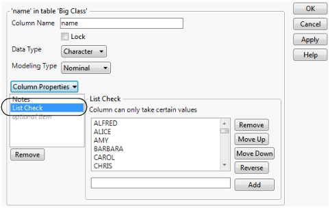

• In character columns with fewer than 255 unique values, the List Check property is added to the column where appropriate (Figure 4.34).
The List Check property restricts the values in the selected column to valid values. The List Check property is not applied when the number of values in the selected column is too great. For example, if the number of values is almost the same as the number of rows, the data table does not add the List Check property to the column.

Caution: In a column with the List Check property, you can enter only a value that is in the list. Otherwise, JMP warns that the cell contains invalid data when you try to enter the new value. See List Check.
Figure 4.34 List Check Property Added to a Compressed Character Column
Figure 4.35 Column Info Window Showing Numeric Column before and after Compression
